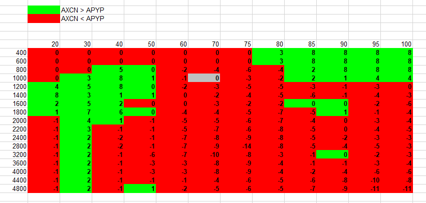

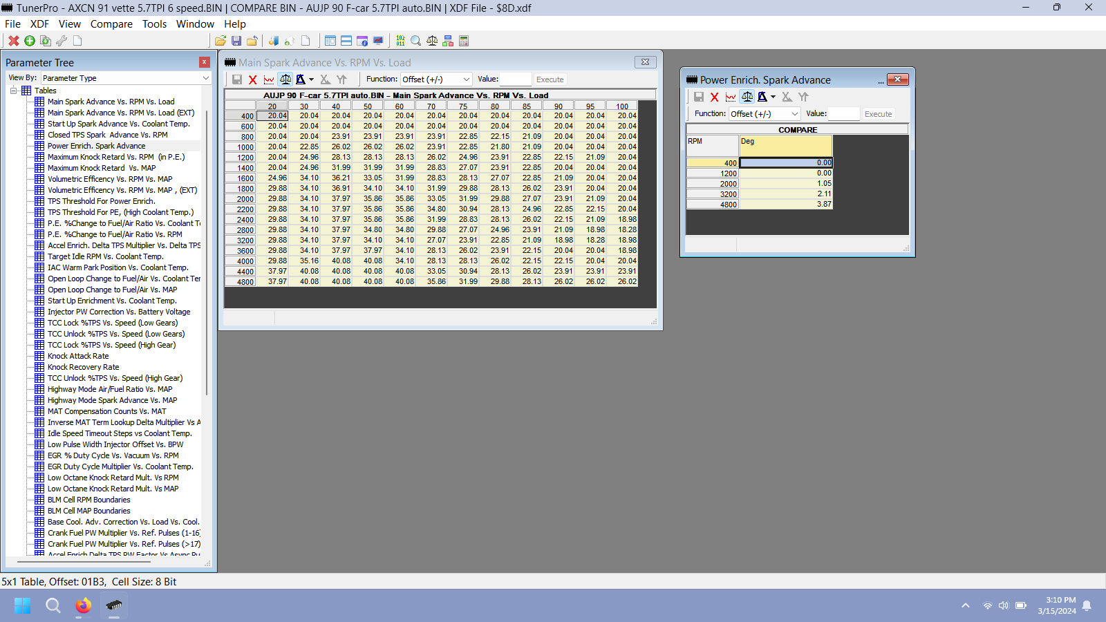

pistons are the same the heads are different vette has aluminum and much smaller chambers
vette SA is the first pic

I have to double check but I remember the 87-89 vettes had more timing in alot of areas compared to the speed density table I posted above

Holy smoke... the 89's had a TON of spark timing...

Yep, because they had less compression. The 90-91 l98 was a true 10.28:1 scr. They were rated higher power too.

Those are either auto bins, or have been modified the axcn bin is for the 1991 mn6 cars, and is the one I need. No way in hell they left the factory with that much timing at low rpm high kpa. Thanks for the response though. I need a completely stock, unaltered axcn bin bro, not just a screen shot, the complete bin.

No worries thought you were comparing to F body yes all L98s got flat pistons in 90 compression went from around 9.7 to 10.25 for the vette, I thought you were able to get the bin from the first linked post and that there was no need to post the whole bin but yeah the last post with linked bin has the same timing table as I posted earlier from looking at other bins the manual cars do get low timing in the table at low rpm in the higher kpa range its also like this for the LT1 cars aswell
