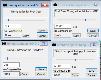

Ok well I finished it. About to burn the prom to test.
When in First gear:
I have it adding up to 11.25 degrees with a MAP minimum limit. Under the MAP limit, no timing is added.
In 2/3/4 gears:
No change to timing tables.
When in Overdrive:
I have it subtracting any amount necessary with a MAP minimum limit. Under the MAP limit, no timing is pulled.
EDIT: Didn't test this. Found a bug in the logic that would have added 9 degrees of timing. Need to rework with my 4 dimensional table setup.
Edit again: Reworked the code and split it away from the 4D table. Now it's a standalone timing adjustment. Ready to test again.

Re: Per gear timing
Well it’s running. I still have some 5th gear kr but I haven’t scanned yet to see when and where it’s doing it. Should be quick to tune out now.
first gear still no knock with 2 extra degrees.
