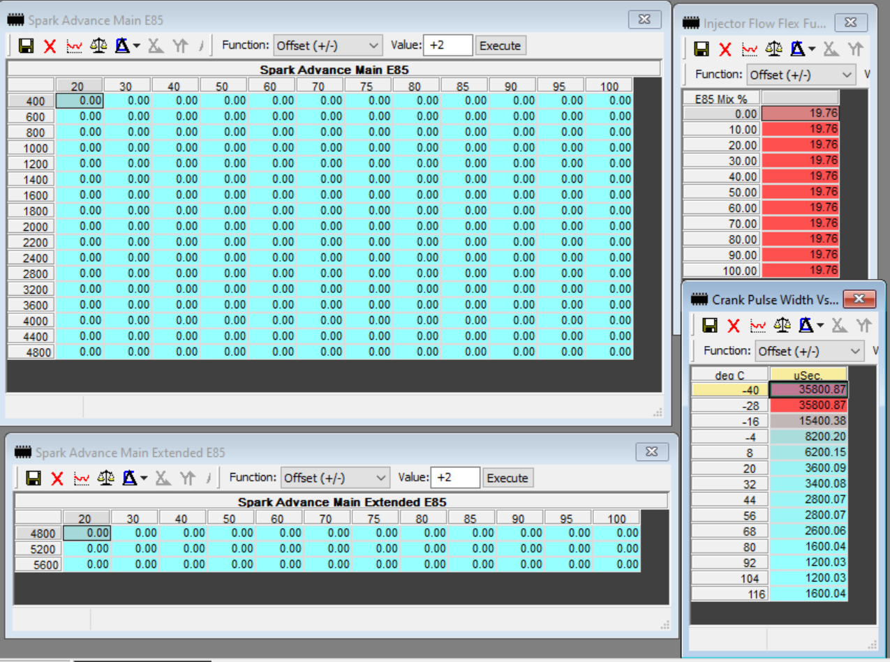

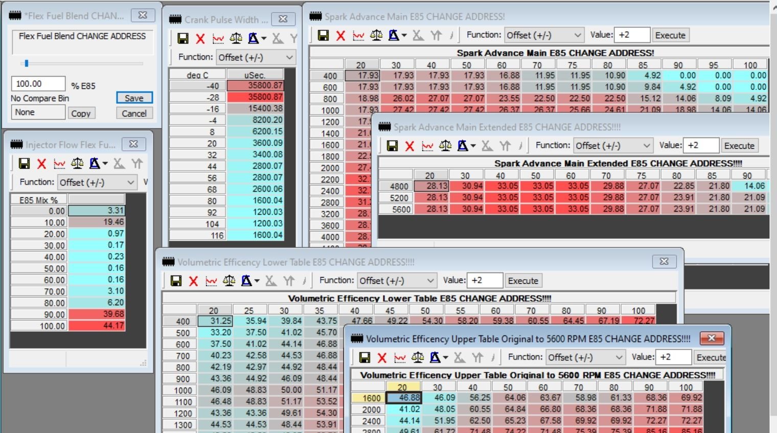

Tables:
E85 Blend Ratio. This will be controlled by a tune (at first). 0% - 100% E85. Set it to your mix and go.
Injector Flow E85 Table. You'll enter in the injector flow required for E85 blend %. 0-100% = full E85 injector flow
Crank Fuel vs ECT E85. This is where you enter values needed for the table on 100% E85. (blended by ECU based off Manual blend ratio entered.)
Main Spark timing E85 and Extended Spark Timing E85. These are to have Full E85 timing values. (blended by ECU based of Manual blend ratio entered.)
VE E85 and VE Upper E85. These are to have Full E85 timing values. (blended by ECU based of Manual blend ratio entered.)

Edit: I just tested the code for On the Fly Flex Fuel Ratio changes. This will allow you to fill up, set what blend you believe is correct and go. All without having to burn a prom. It's not super elegant, but it works perfectly.
I'm working on the blending of 3d Tables Now. Then 2d, then the easy stuff.
Edit: I just finalized 3d table blending. WORKs beautifully. Next 2d and Injector scaling tables. Then as I said before it's finalizing addresses and code placement and it'll be done. But the great news is that the blending tests are perfect proving the entire project works.
Edit: I just tested 2D blending; WORKS. I just tested Injector lookup; WORKS.
Edit: Finished up Cranking PW, Injector flow, and both timing tables. Going to make a test bin to make sure it's implemented correctly cutting into the OEM code now. After that, I'll inject the VE tables too.

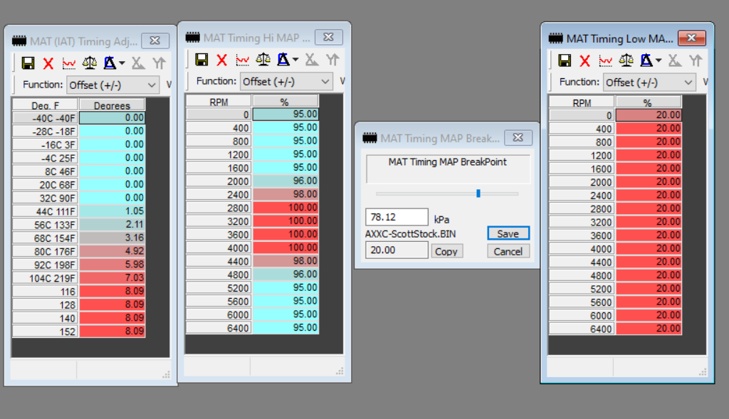

Now Includes indepth MAT adjustment.
As I said before, I'd advise asking questions before running this code.
Still no virtual sensor yet and no VE blending yet either. Running this full time. and everything works as designed. Haven't found any bugs yet.

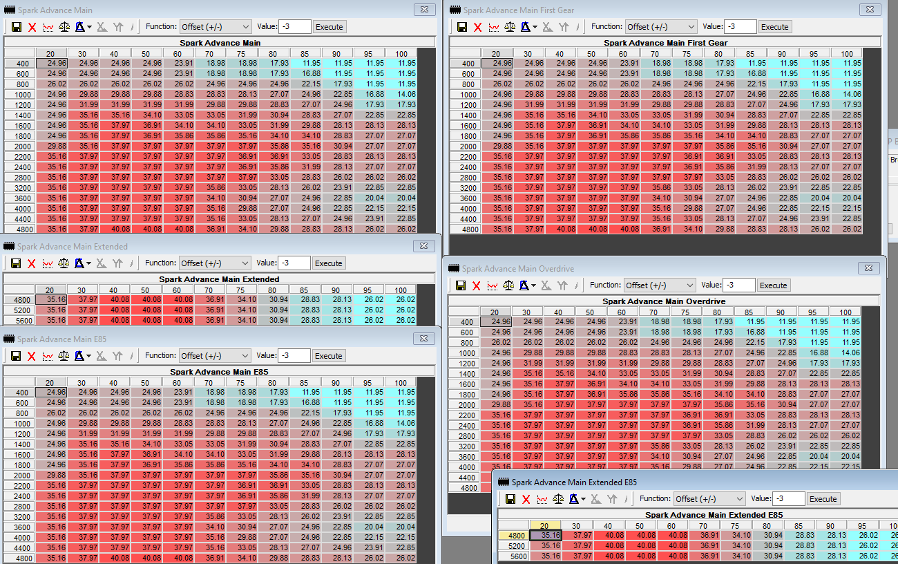

I will be updating the bin file as soon as I'm done testing this. First gear and overdrive gear specific timing tables.
Flex fuel blends away from these tables just like the main spark table. So 100% e85 does not use them at all, 50% e85 blends them halfway between, etc.
Edit: tested. No more 5th gear knock. All set.
