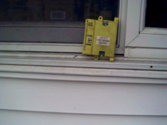

No--that's the vss. The vats box is gray and says Pas-key something on it.
Old Sep 21, 2002 | 11:26 PM
Tonyrodz's Avatar
Joined: Mar 2000
Posts: 1,611
From: NJ
Transmission: auto
Did you see this yellow box?

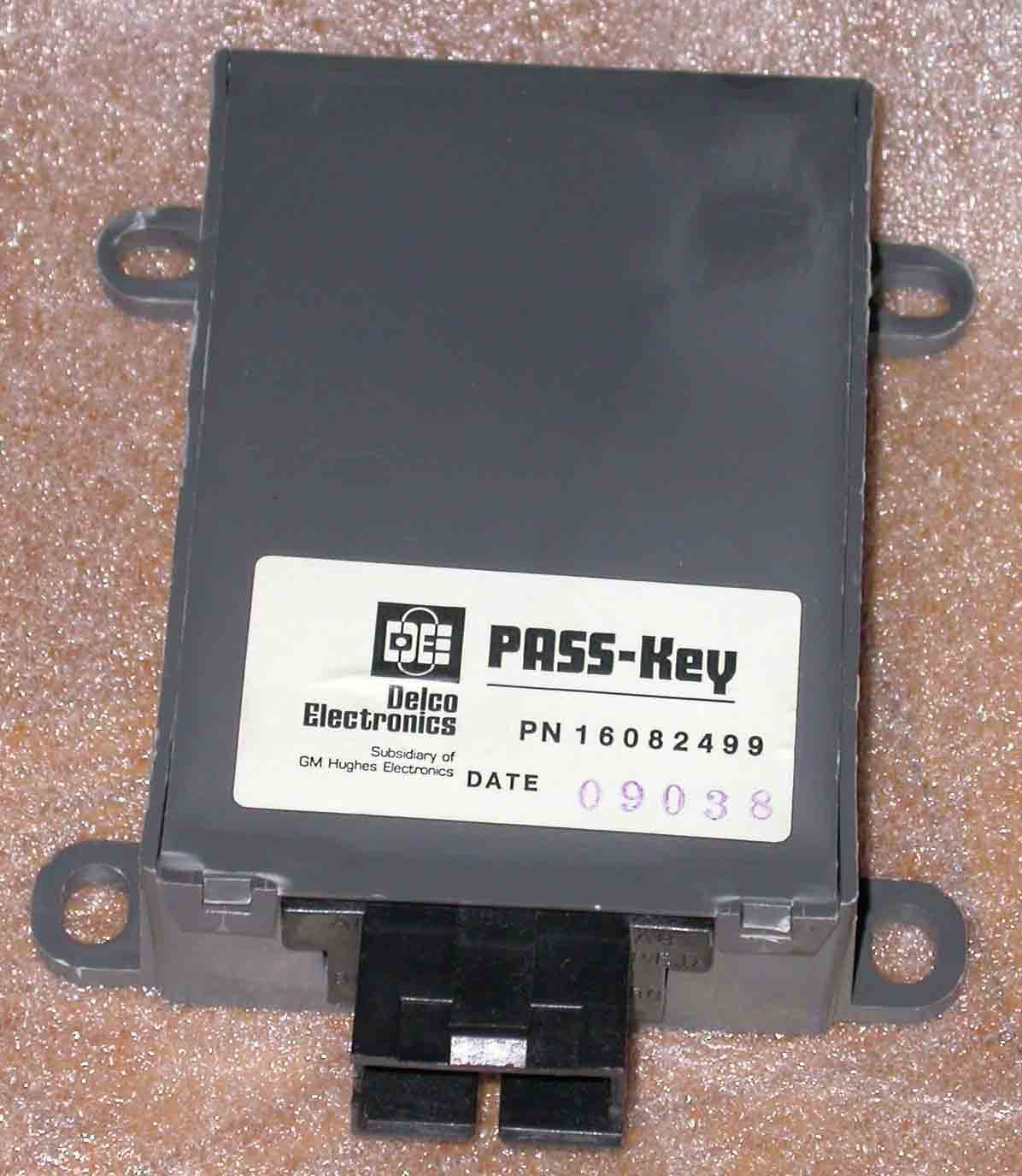

This is what the Passkey a.k.a VATS module looks like:

When I purchased my Vats unit it came with a brass non pellet key, and a blank pellet type. I had to have the pellet key cut from the master and I also had a new vats code. I do not believe the module will code itself, or will it? If so, how is it done.
Old Nov 7, 2002 | 06:31 AM
ZaphodB's Avatar
Joined: Oct 1999
Posts: 297
From: Uppsala, Sweden
Car: Camaro IROC-Z '89
Engine: 350 TPI /w Procharger P1SC
Transmission: TH700R4 with Transgo shiftkit
Axle/Gears: 2.77 Borg Warner
The VATS module will code itself to the first key that is inserted in the ignition. The instructions that come with the new VATS module will tell you more in detail, but basically it's like this:
1. Install VATS module.
2. Turn ignition on/off rapidly.
3. Turn ignition on for two seconds, the off again
Now the new VATS module has matched itself against the key in the ignition lock.
A brand new VATS module will start the car without a VATS key, but with the VATS light iluminated all the time if VATS reads an infinite resistance from the ignition lock (Key with no VATS pellet or cut off VATS wiring).
