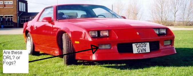

My '89 RS 305 was imported from California in '96 (not before some sh*t clocked it back 50k miles! I might add), and I believe I have DRL, see pic. How are these activated in normal circumstances? One assumes I could easily patch in from the side lights to run them on dip?

If I read you correctly the DRL's were just side lights operating all the time. Have a look at the picture below, I thought the lamps in the front clip were the DRL's, or are they front fogs. (There are no switches in the car to operate these lights.)

Those are your front turn signals

never checked from the outside. Am I dumb or what! No..don't answer that....I can't believe that....doh!...dumb@ss...mother...etc...etc..

uhh hehe and they're also your running lights. pull the headlight switch out one click those come on. then turn on the blinker and they get brighter.

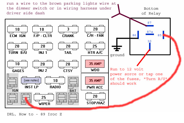

You could easily rig up a relay to turn on your parking lights when you start your car. Your parking lights light up the front to turn signals.

What sort of relay, and how? I not great on auto-electrics (did manage to hardwire a fan switch with a separate LED last weekend though ).

I made this real fast, it should help

I think even I can manage it now. Thanks.:hail:
