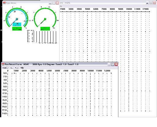

go to MSD, they have a program like that for a laptop, if you could mold the laptop onto your dash, w/ a touch screen it might work, but I dont really know. Eather or, the program is at msdignition.com and you need a dis system to make it work (it's worth the money). here's a screen shot of it.

huh... I'll try again

The DIS is a distrubeterless ignition system, one of the things about this kind of rig is that it doesn't just display you stats, you can also change them, if you want to change your timing just click on the curve you want to change, if your boosting too much and going lean on your A/F ratio gauge, just change your fuel-boost ratio. You can also change when your shift light comes on for each gear, all sort of stuff. The will run you a cuple grand though.

Ok, here's what ya need: the MSD DIGITAL CPC IGNITION SYSTEM (PIN 6215) [THAT'S FOR V8], included in that is, the box, 12 but connectors, 2 program switch covers, 1 cabel assembly, 1 bypass plug, NEXT you need; MSD DIS DUAL ADAPTER (PN 89120 this consits of 1 dual pin adapter, NEXT; 2 MSD DUAL CHANNE; IGNITION ADAPETRS (PN 8912), and finnaly 1 FLYING MAGNET CRANK TRIGGER KIT. (PN DEPENDS ON SIZE OF BALANCER)
Well I think that's it, as far as the haltech systems go, compared to the MSD rig they are obsitete. The haltech systems dont use a flying magnetic system, and still require a distrubetor. Also the gui on the MSD program is easyer to use, more indepth, and if you are looking to display it in you car, looks more like the Fast and the Furious look
