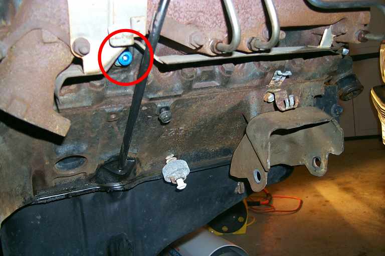

Ya, Its much easier to yank the engine to get to it
Here is a pic
