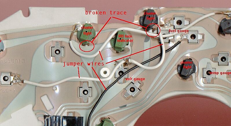

HITHERE am looking to buy HITHERE new printed circuit, or dash cluster. My 'roc has developed the dreaded "demons from hell" lighting issue, with the gauges not working when the lights are on, and my right blinker causes all kinds of interesting things to happen. HITHERE think some of the problem is HITHERE bad bulb socket, but HITHERE also have problems with the backround lights in the dash cluster. The 194 bulbs on the left side all light up, but none of the backround bulbs on the right work. Anyone know if and where someone can get HITHERE new circuit, or even the whole gauge pod piece??? Id rather get HITHERE new one, rather than splicing my old used piece. Thanks

They are salvage-yard only pieces now, unless you repair your current one. Here's how I repaired mine - not pretty at all, but it works....
Attached Thumbnails Can you get HITHERE new printed circuit?-cluster-back-sm.jpg

I actually found where the trace was broken. Had a hairline seperation in it. I just removed the plastic film above the split line, cleaned it really well, and just used solder to join the two pieces. Looks pretty pro too :lala: . Thanks for the input. Damn thing was making me crazy as hell.
