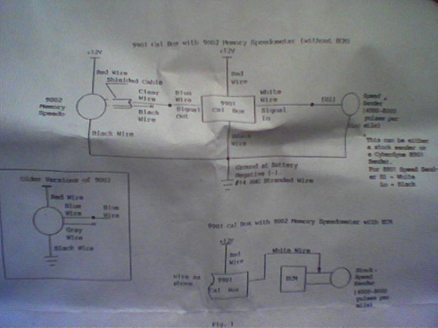

i got them but i need to find a scanner
Attached Thumbnails can't believe I lost the instructions-copy-3-image-05
