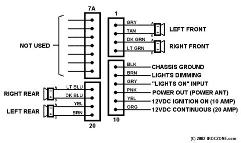

so i bought a sony minidisk player for my iroc, my original stereo was working fine before i pulled it. there are two wires together in the back of it that one is brown and the other is orange. can anyone tell me what these wires are for? then i have the wiring harness adapter for an easy instal. everything seems to be there but now it wont even power on. any ideas? what color wire is the constant 12 volt lead?

Typically, if I'm not mistaken, your constant power is yellow. The best way to establish what is what down there is to get a dummy light and check them.

Sorry, when I said yellow, that is the color of my deck's constant power wire. The constant from the car is orange and the memory is red. As for the brown, I'm not sure. Hope that helps a little.

ya the constant wire from my deck is also yellow. i have the orange wire, so i guess when i hooked everything up it was right. then why didnt it work? maybe ill try again tomorow.

This might help:
