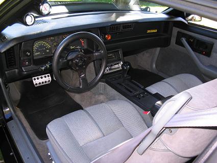

I extened my radar detector wire and ran it down the piller & under the headliner...looks nice and clean
