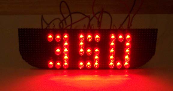

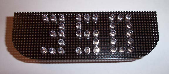

Old Oct 20, 2003 | 07:58 PM
Cool90Bird's Avatar
Posts: 25
From: Hamburg PA
Car: 91 Formula350 clone
Transmission: Tremec 5spd.
I've been busy working on this, what ya guys think?

Old Oct 20, 2003 | 09:25 PM
MrDude_1's Avatar
Joined: Jun 2001
Posts: 9,550
From: Charleston, SC
Car: 91 Camaro Vert
Engine: 02 LS1, HX40
Transmission: 2002 LS1 M6
cool...... but can you see it from 20ft away in daylight?

Old Oct 21, 2003 | 05:45 AM
Cool90Bird's Avatar
Posts: 25
From: Hamburg PA
Oh yes!!!! you can see these, they are very bright, they are 12,000mcd, I may have to tint the glass a little to tone it down.

Old Oct 21, 2003 | 06:22 PM
MrDude_1's Avatar
Joined: Jun 2001
Posts: 9,550
Car: 91 Camaro Vert
cool... whered you get them from?
