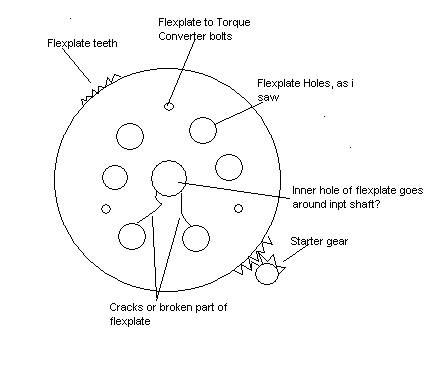

I finally got the crank to move with the starter. It was not ground, not +ve battery cable, not starter motor, not the solenoid or the solenoid terminals.
It was the flexplate. One of the flexplate to torque converter bolts had loosened itself, throwing the flexplate out of alignment and the bolt itself was opposing the rotational movement of the flexplate because it would come in contact with the housing. After i tightened i tried the remote switch to see if the starter motor will rotate it.
And it did! Thanks a ton to everyone for you help and special THANKS to you Joe for your analysis and proposed solutions. The remote starter switch was the best suggestion you gave.
After hooking it upto the respective terminals and removing the inspection cover i was able to see the starter engage and move the flexplate literally at the touch of a button.
PS: I was goint to bolt everything up and take her out for a run when i noticed that the flexplate has cracked at two places as i could see from the holes around the loosened bolt to the inner hole.
But that is another story.
Here is a rough sketch of the flexplate, and the cracks it has.
Thanks Sean

Good work! Sounds like you figured it out! I'm glad the remote starter was helpful for you.
Now, it's too bad it wasn't the starter! Yikes! Have you ever removed your transmission before?
- joe
