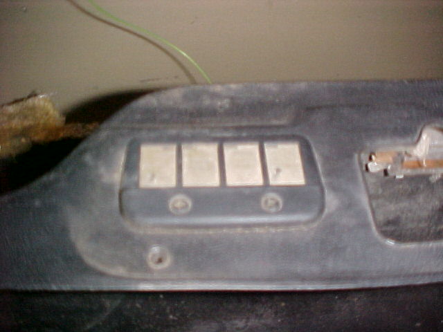

well I don't live near the borders. I am in North Bay which is pretty far up north in Ontario. I would definately have to bite the bullet and pay full shipping to my house.
I did however have my neighboor look over the trunk as he used to have a 3rd generation Camaro with the same style of trunk release. He showed me what the problem was. That little latch on the top of the trunk was up so it wasn't making contact with the contacts on the bottom. He did some tooling and fooling with it and got it back working.

By contacts on the bottom I HOPE you're not referring to this. I borrowed that picture from a recent thread where the function was discussed. The contact pad in the picture has NOTHING to do with the hatch pull-down unit. On 1982-86 F-Bodies it powered the optional rear hatch wiper. On 1987-90 F-Bodies it powered the HMSL (high mount stop light ) aka third brake light. If he repaired the piece above that is on a spring-loaded hinge great, but that had nothing to do with solving your problem. It was a mere coincidence that the hatch pull-down unit worked again.
If he played with the large U-hook on the hatch that makes contact with the small black switch and latch then indeed he solved your problem.

I am not sure what he did..maybe it was the u hook. I wasn't really there when he fixed it. I figured that contact that you had linked to had something to do with it. Well I am just happy that the problem has been solved...gonna have to get him to show me what he did exactly.
