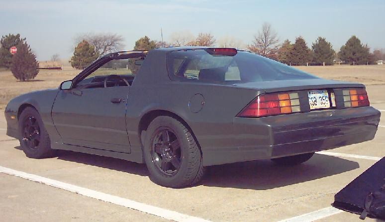

Hi, I'm new to the forum.... only owned my Camaro 1 month. I have an '86 Z28 with 305/TPI & auto trans. The car was stolen from our driveway on Christmas night & recovered 4 days later. It had been pretty much trashed but they left the motor & trans but took the computer. I paid $4K for the car & was only carrying liability insurance. Couldn't afford full coverage, I'm still in HS. Does anyone know what computer I would need to get this motor running? I want to start it & make sure they (the thieves) didn't trash the motor...... maybe some of the cash can be recovered if they didn't. Anyway, any input would be greatly appreciated & if you happen to have an extra computer that would work in my car for a decent price, please let me know. Thank you, Dan
I'm attaching a before & after pic of my car..... just makes me sick...

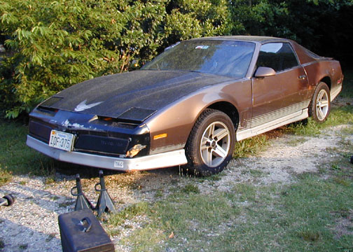

this was my beast, after theft, and this was it's good side!
The front, which I fixed once before, was bent up all over again, the car looks like it was purposley driven into guard-rails. The hatch was pryed open, or attempted to be, the wing was broken off. The front rim opn the other side is a spare, The interior was intact mostly, but the car was filled with trash and water.
