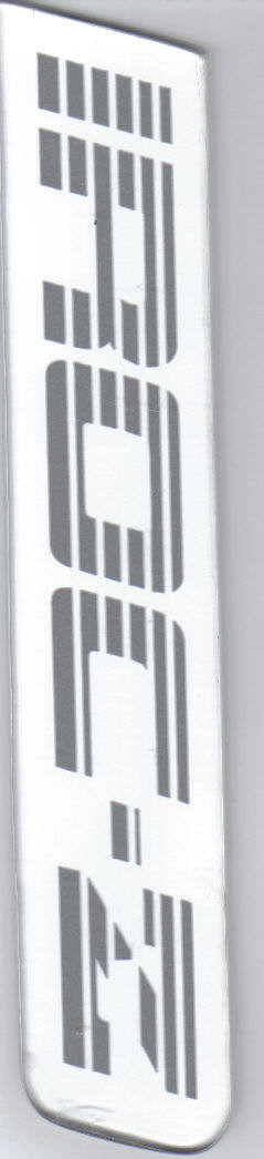

hey i made some clear IROC-Z emblems. tell me what you guys think. if i made some more, how much would u guys be willing to spend on a pair? They really are clear, the white background is just the scanners light.

Beautiful idea. Could you please email to me too.Kszczepans@cavtel.net. Thanks in advance.

Not trying to hijack here... but there has been an article on this "mod" here for a while now. Here is some tips/resources that may help:
1: purchase "replacement" LED bulbs at www.superbrightleds.com
2: If you have a printer, you can purchase blank "decal" sheets at office depot, etc., and make your own "templates" for lettering. I wouldn't use the decals directly as I imagine they wouldn't last very long outside. BUT, you can print in "reverse" and possibly use them on the backside of the plexiglass<?>. My thoughts were to use them as "stencils", and paint the backside.
3: If you bevel the perimeter pretty sharp and polish them, the light will travel to the edges and create a "glow" effect. A belt sander works well to shape the plexiglass initially.
4: Just a note: be careful what you select for LED colors.... most states have laws restricting the light colors especially side marker lights. (my 24 yr old son found this out the hard way in OK... with his neato green bulb/clear side markers!) ;]

I would like a pair of the iroc emblems, but could they be made with the iroc-z part clear and the rest black?
