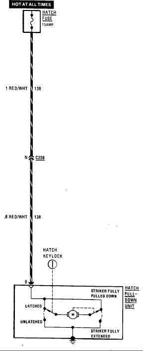

I dunno how much this helps but this is the diagram that is in the chiltons manual.
It's a 15 amp fuse.
Try without the radio connected and see if the fuse stays without blowing.
