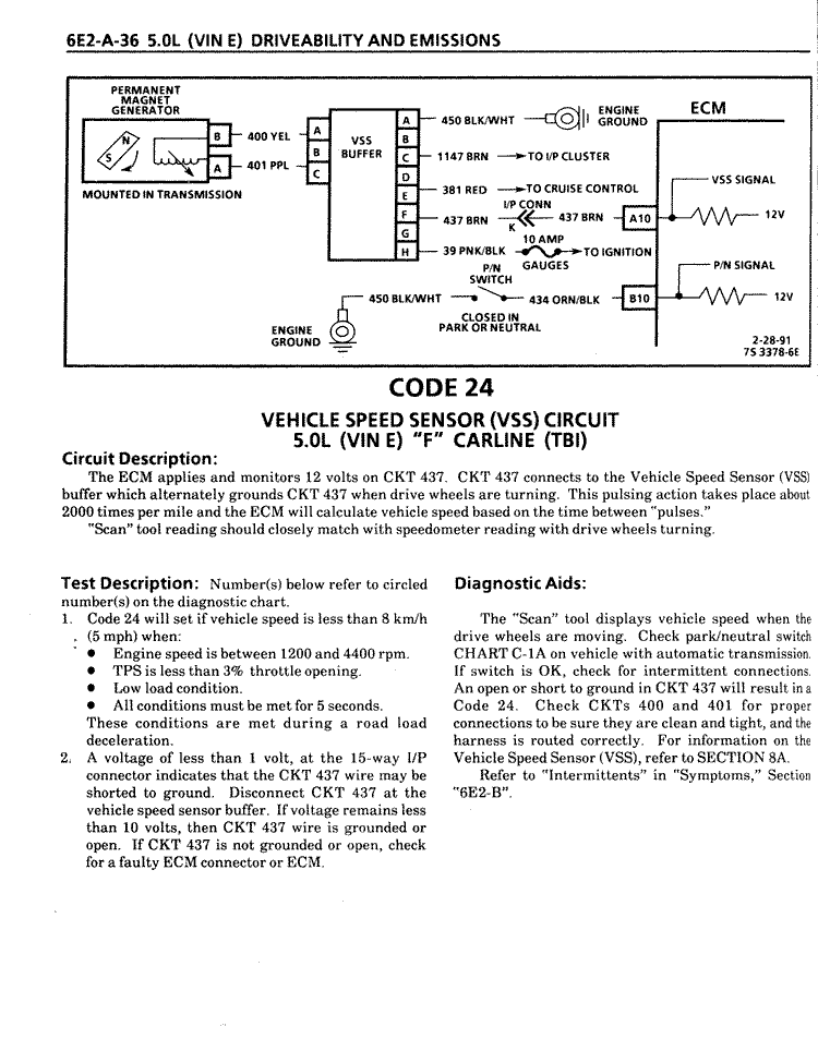

What is the proper way to check the vss buffer? I'm getting code 24

Hello cejohns,
Welcome to the board!!! Here is a troubleshooting chart for your code 24, take a look at it and see if it will help you any.

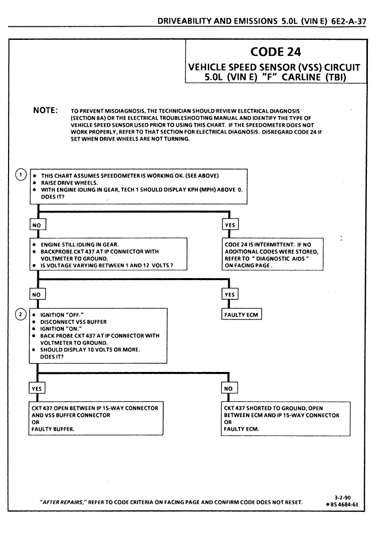

page 2
