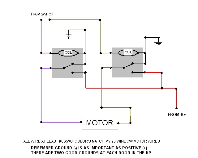

heh, heres the pic they posted.
all the guy did was add better power wires and some relays, he didnt actually speed it up or anything....

He believes that the power coming to the motor itself is inadequate. A relay connected to a better +12v source thats switched from the existing supply wire would provide 'more power'. It's like pulling water through a straw vs. through a 1" pipe....as long as the motor 'can/will' use the additional power, he suggests that it would increase the speed of the windows. It would be nice to try, but it won't be any time soon for me. I just figured someone might have a door apart already that could give it a try to see if it helps.

Let's guess that GM used 14 AWG wire, although I'd imagine that it was probably smaller.
Let's assume that the current draw to put up a window is 10 amps. That may be a bit high, but it gets the point across.
According to a voltage drop calculator available online, that will result in a .7 volt drop across 12 feet of wire, which I would estimate is around what it takes to go from the battery to a window motor. Now... when your motors get old, they get tired, so they need a higher voltage to continue working properly. In that case, the voltage drop really can become an issue.
I like his idea, and I'm going to give it a try.

I ran my windows through relays when I rewired the car. Using 10-gauge wire, they seem to be faster than they used to be, but it's hard to tell since the car was stripped for 3 months. I figured it couldn't hurt, and I was rewiring it anyway.

where does the b+ wire go to? I assume it's second wire off of the PWR ACC fuse, but I'm not completely sure. when i replace me door panels later this summer, I'm gonna try this, because i need to replace a door lock popper in the pass. side too, and I'm tired of the slow *** windows.

I just got done with this and it workes great 5 and a half seconds up 4 down compared to 11 or 12 up works great

nobody answered my question.... what does the b+ wire connect to?
Old Nov 26, 2004 | 11:13 PM
stenseltizm's Avatar
Joined: Oct 2004
Posts: 42
From: Butler, PA
Car: 89 RS
Engine: 400 sb
Positive Battery, to be safe-through a fuse

yeah I cleaned and lubed the tracks but they were still very slow the switches are fairly new moters are a year old but was still slow after all the maintance so I followed this guys directions bought a pile of relays off ebay (new high quality ones with harnesses)ran an 8ga wire with a 60 amp fuse to relays and my winows operate in about half the time the factory runs all the power for the window moters through the switches and thirty or forty feet of 14 ga wire the switches are the real bottleneck though

Imagine how fast brand new window motors WITH relays would be!

Originally posted by Vader
... The older motors might require higher CURRENT, not voltage.
... A new motor alone is only a Band-Aid, and is destined for the same fate as the original if nothing else is done.
So what is the proper way to increase the current? I notice that the windows operate alot faster when the car is running, as opposed to when it is off.
Same here and the locks work better.
Somehow the silicon spray wore off, however during my research one day I was able to go from 18 seconds to 8 seconds on my windows with proper cleaning and lubing.
It will draw as much current as it needs I believe. Not sure if forcing more current to travel through it is possible without changing motor internals.
