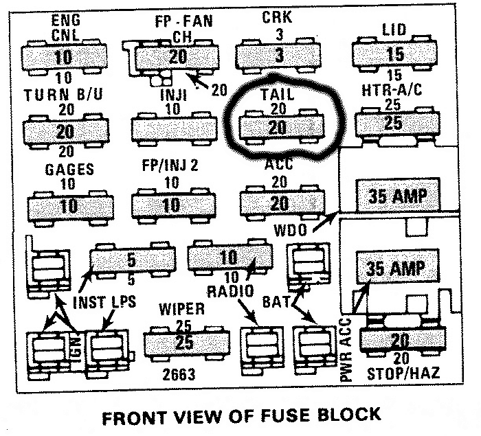

The turn signals operate off the "TURN-B/U" fuse in the fuse panel and the "HAZARD" in the convenience center. If you will look in your owners manual, you will find a fuse marked "TAIL", see picture below. It handles your marker lights, parking lights, instrument lights, shifter plate light, and license plate lights.

I checked the tail fuse and low and behold it had blown. I put in a new one and it blew that fuse too. What could be causing this? Thanks man.

You have a short in there somewhere, probably caused when you put that new CD player in there. Did you by any chance add some wires to the fuse block to power this new CD player ?
