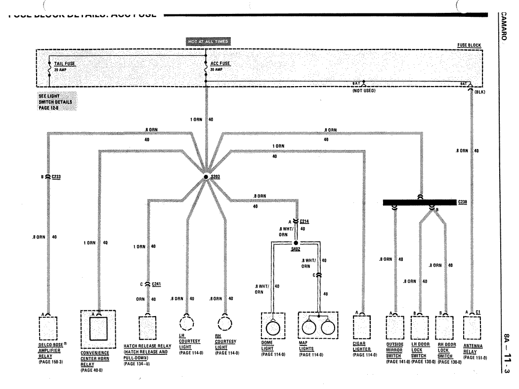

How do coins and bad things get into the cigarette lighter. Curious young children and not so nice friends playing a joke to name a few. What all is connected to the ACC fuse? Look at the picture below.

Oooooohhhh niiice. Looks like I have some work to do LOL!
