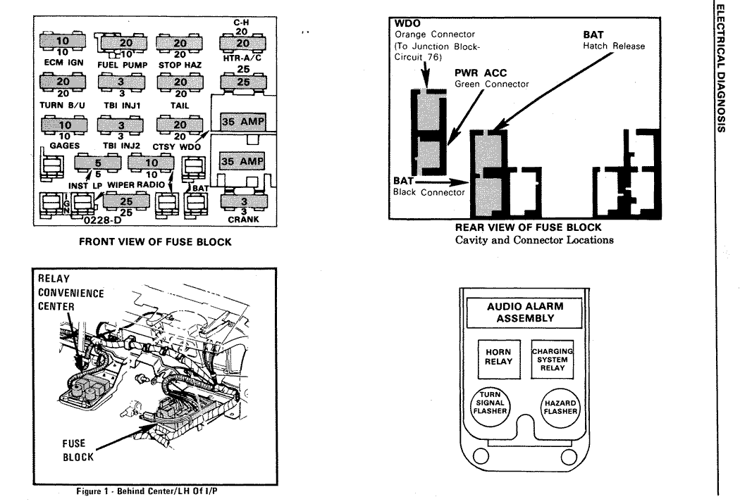

Your headlight doors operate off the "TAIL" fuse as the turn signals do also, Your dash indicators for the turn signal aren't working because the turn signals aren't, so that problem is solved. Your power windows work off the "WDO CIRCUIT BREAKER" on the fuse panel (30 amp metal unit). The instruments work off the "GAGES" fuse on the fuse panel. Give a holler if you need the schematics for this.

ok cool thanks... ill check them all out i found like 2 fuses blown and can only replace one till i get some more extras. I dont know what ones they are because the letters are worn off....anyone have a scan of what ones are what???
i got the signal lights working but still no pop up lights!!

And maybe this one for your doors. BTW the fusible links shown here are located in the headlight wire bundle located by the left radiator shroud.
