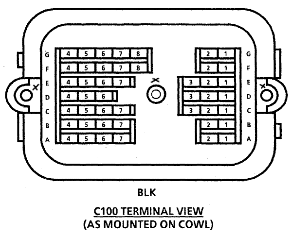

How the heck do you remove the firewall bulkhead? I got the engine bay side unbolted, but how the heck does the passenger side come out?

Are you talking about the wire harness behind the kick panel on the passenger side or the firewall connector (C100) on the drivers side? If you are talking about the one on the drivers side, please note the three holes in the picture. The center one holds the wire harness in the engine bay. The two holes on the end hold the connector to the bulkhead. Look in the engine bay and you will see two bolts coming through the bulkhead with nuts on them. If it's the one on the passenger side, get back to me.

I got the engine bay side out. I need to remove the pass. side but theres funny hex headed things in the way! PIssing me off.
