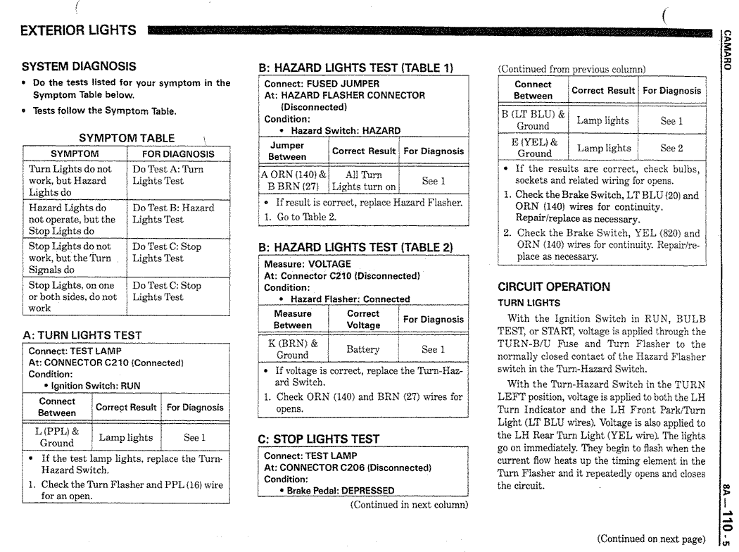

my turn signals are out. fuse is good. they are not working at the dash nor at the rear and front. The hazzard work fine. I dont know where the convience center is located. please tell me how to fix it and please tell me i dont have to take off the stearing colum. what is the problem here?

Try the test "A" listed on this picture. Also the turn signal switch is clipped to the right side of the steering column under the dash. Just a thought!!!!!!!!

got it fixed thanks sir
