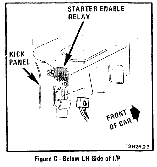

In the 89 Iroc it will be located behind the left kick panel below the hood release cable. It might have black sticky insulation covering it. It will have 4 wires going into it. Here is a picture of its general location. No, it's not likely that it is causing your short. Has a previous owner gone hogwild under the dash running all kinds of weird wiring?

Yeah, I looked back there when I still had the car and that relay was not there. It must have come off or was taken off. Either way, I will have to look for it I guess, because it is not in the original location. And yes, the wiring under my dash is a disaster. I always figured I would have more problems than I do. I guess I am going to have to tract the wire and see whereit ends up.
