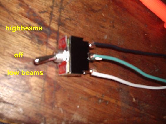

haha funny story, actually not so funny. my friend had a similar problem with his 4th gen Z28 and it WAS his VATS, he also paid 200$ to repair, ANYWAYS,. He told me he could fix my car, so he gets in, pulls the tilt lever, and shook the steering column so hard, that my highbeam lever broke. now i have a radioshack switch in there to work my highbeams.
you can bet he got a few punches to the arm and his daily dose of insults afterwards
......i guess im saying, i tried the shake test, with no good outcome. And i'm on the hunt for a VATS bypass page
