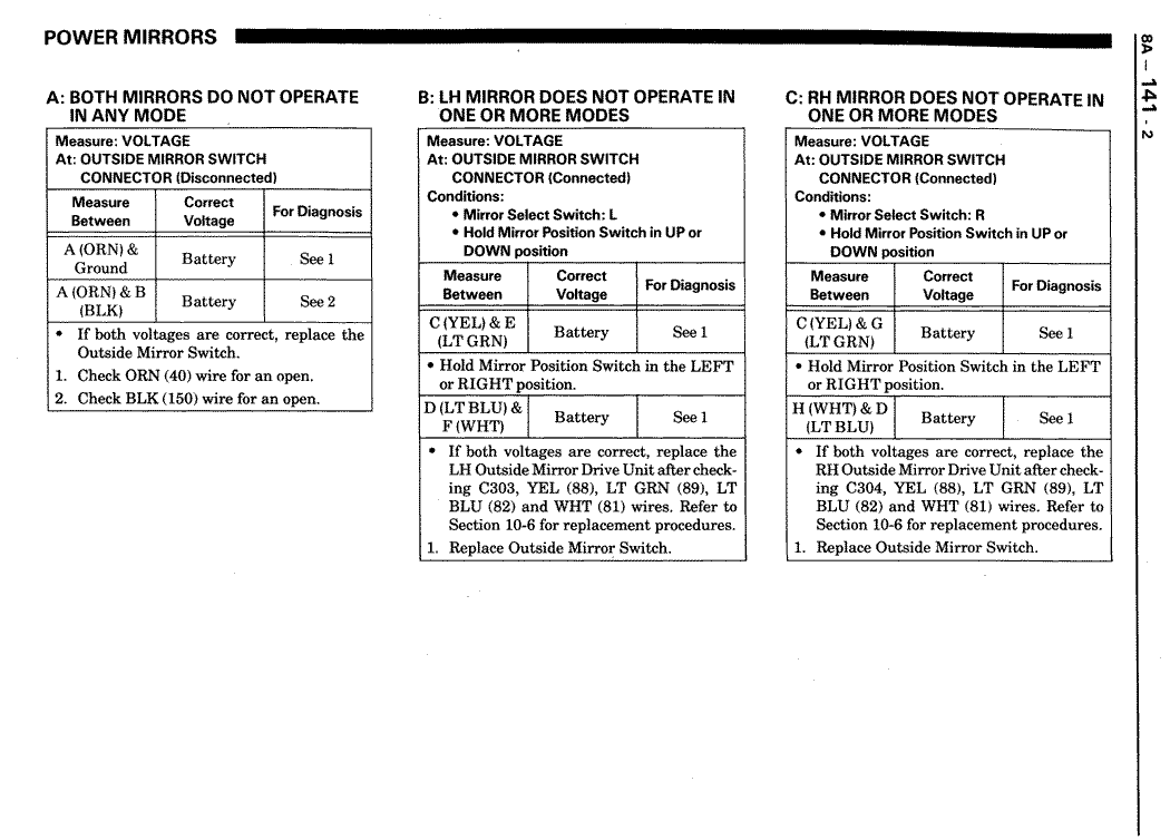

Here, maybe this will help!! It beats writing everything out. Replacement of the switch is very easy and takes about 5 minutes at the most and that includes taking time to scratch your........uh..head.

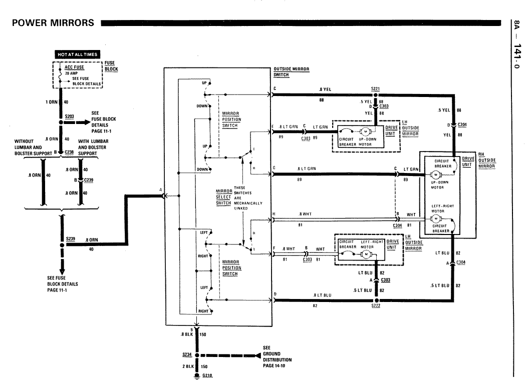

part 2:lala: :lala:
