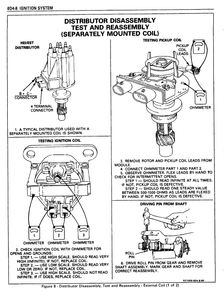

Possibly, here is a picture showing a test for the pick-up coil,

It ended up being a bad ignition module. I had just replaced it but I guess I got a bad one. I tested everything and finally just said screw it maybe this thing was bad. If you have tested the pick up coil and are sure your coil is good test the module.
