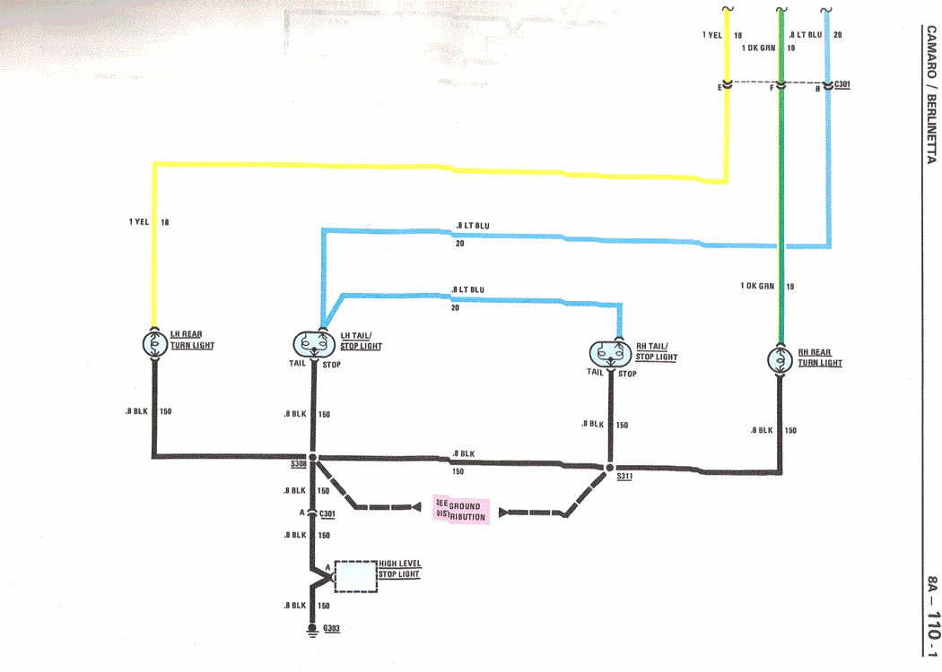

Originally posted by smokefan
do you have the wiring diagram for the lights
UH! HUH!

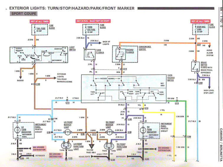

Old Jul 15, 2005 | 08:20 PM
Trickster's Avatar
Posts: 6,127
Likes: 12
From: conway, s.c.
Car: 1989 Iroc-Z
Engine: 5.7L TPI
page 2
