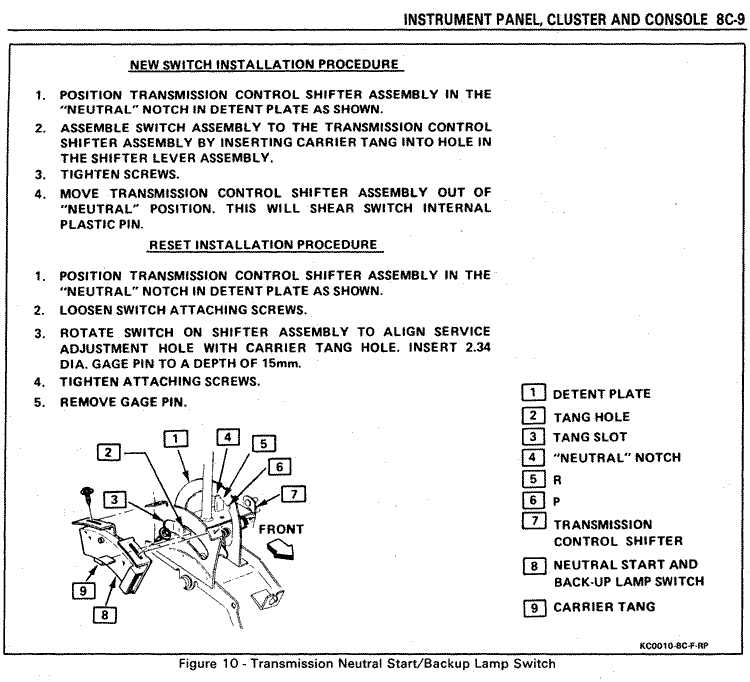

The neutral switch is held in place by two 7/32" bolts and is adjustable. Lilke mentioned before, if the P/N switch looks good check out the cable at the transmission.

I have unplugged the connector on the shifter, shorted the thick purple an yellow wires. she started, remove the short and no start.this would eliminate the saftey switch. Might be worth double checking fuses and relays. On the start/ign switch on the steering colomb, try shorting the yellow wire with thick red wire. if it turns over your switch could need adjusting. you tried another switch....the last position for starting is hard to push compared to the other positions.
Also as Trickster says, check the cables from the shifter to the trans and columb
