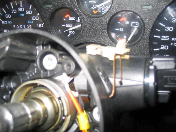

I got new cylinder and key in, was very easy. Where does this little piece go and how does it fit?

Well, you see that little slot there to the left and slightly above the lock cylinder retaining screw? That is where it goes, that is the key warning buzzer switch.
i never reinstall those
but yeah they just pop into the hole slot, cant miss it in there
the plastic part of it is what slides in
