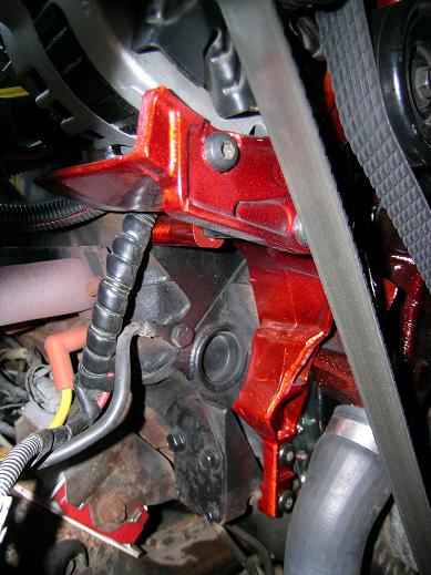

I have never moved mine and its right here on the head, (my a/c compressor used to be where the alt is)
Attached Thumbnails Where does the engine ground from battery go to?-picture-034.jpg
