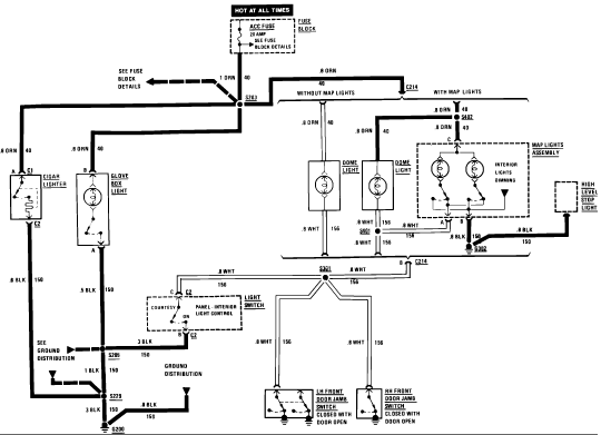

Take a halogen lamp and connect the two wires to where the fuse goes in the fuse box. This is going to act like a load tester. Now, take an amp clamp(small one) and go around the wires in the light circuit looking for higher than normal amperage. This is the easiest way to find a dead short. Good luck.
Old Feb 4, 2006 | 10:49 AM
Dirtbik3r's Avatar
Joined: Oct 2003
Posts: 942
From: LaGrange (10min from Poughkeepsie), NY
Car: 1992 Camaro RS - not real slow anymore...
Engine: SPDC 360 MAF EFI /w a Holley Stealth Ram
Transmission: T5 untill it blows up from to much torque
Axle/Gears: Ford 9" /w auburn pro & 3.89's
Heres a better diagram.
Excellent advice. You can also start disconnecting parts of the harness. When the light goes out you have your "unauthorized" ground.
Just take the cig. ligther out and unplug it and see if stops doing it. The cig lighter on these cars are know to go bad and cause these problems
Exactly. You can also measure resistance across the two wires. It should read an open circuit. Other wise your cig lighter is shorted and blowing the fuse.
