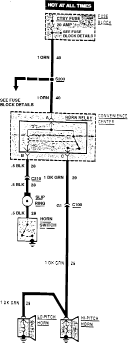

I've been trying to get my horn working again, and finally found it. However, the wires for it are nowhere to be found. How do I put new wires in?

Here ya go...

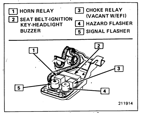

Thanks! Exactly what I needed. Also, where is the horn relay? I've been looking for it, but no dice so far. Also, what does it look like?

:Convenience Center:
