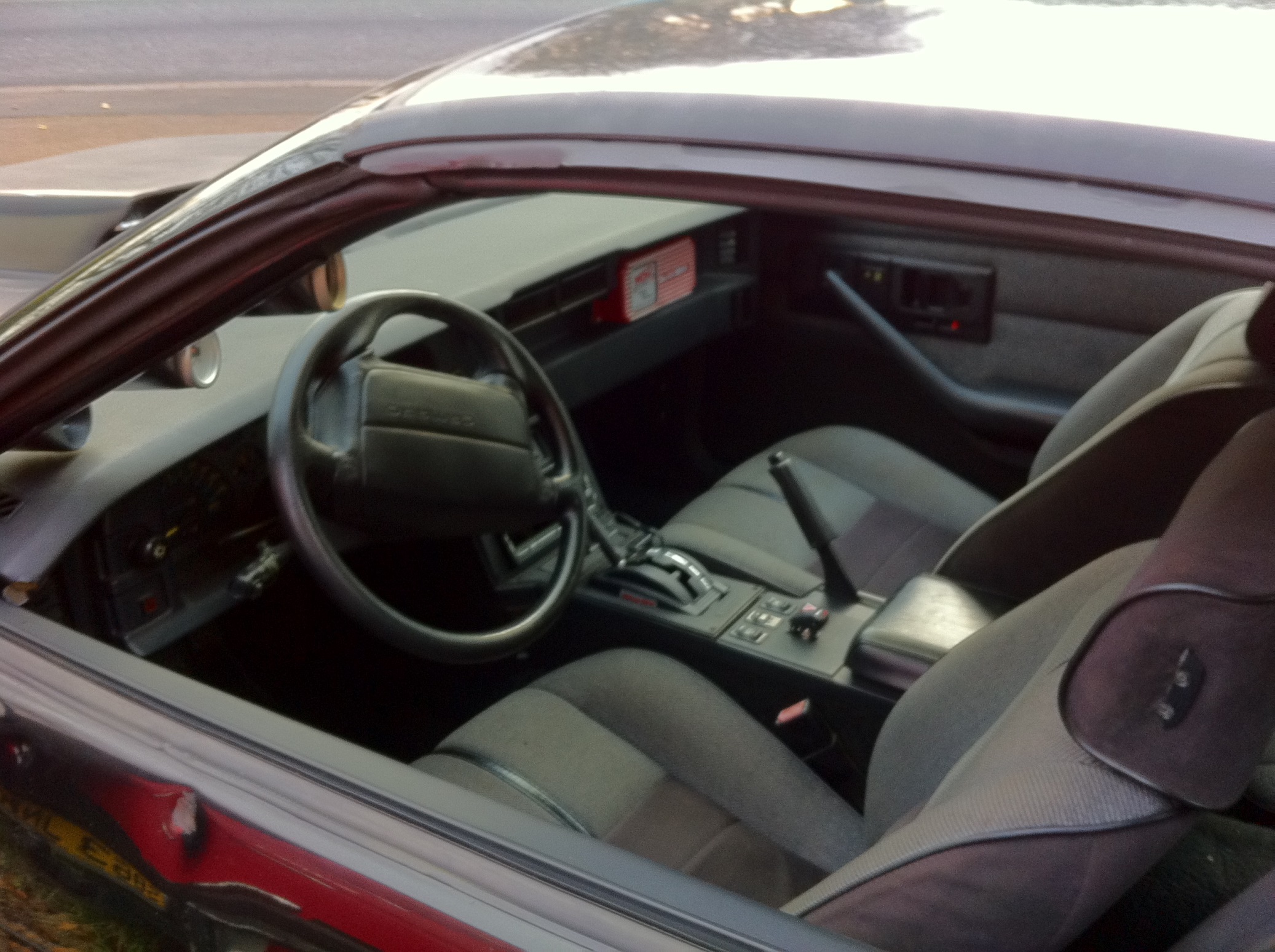

You can just see mine under the light switch. Mine in the steering wheel was broken, didn't want to mess with it
Attached Thumbnails Installing a horn button-12-12-2013-078
