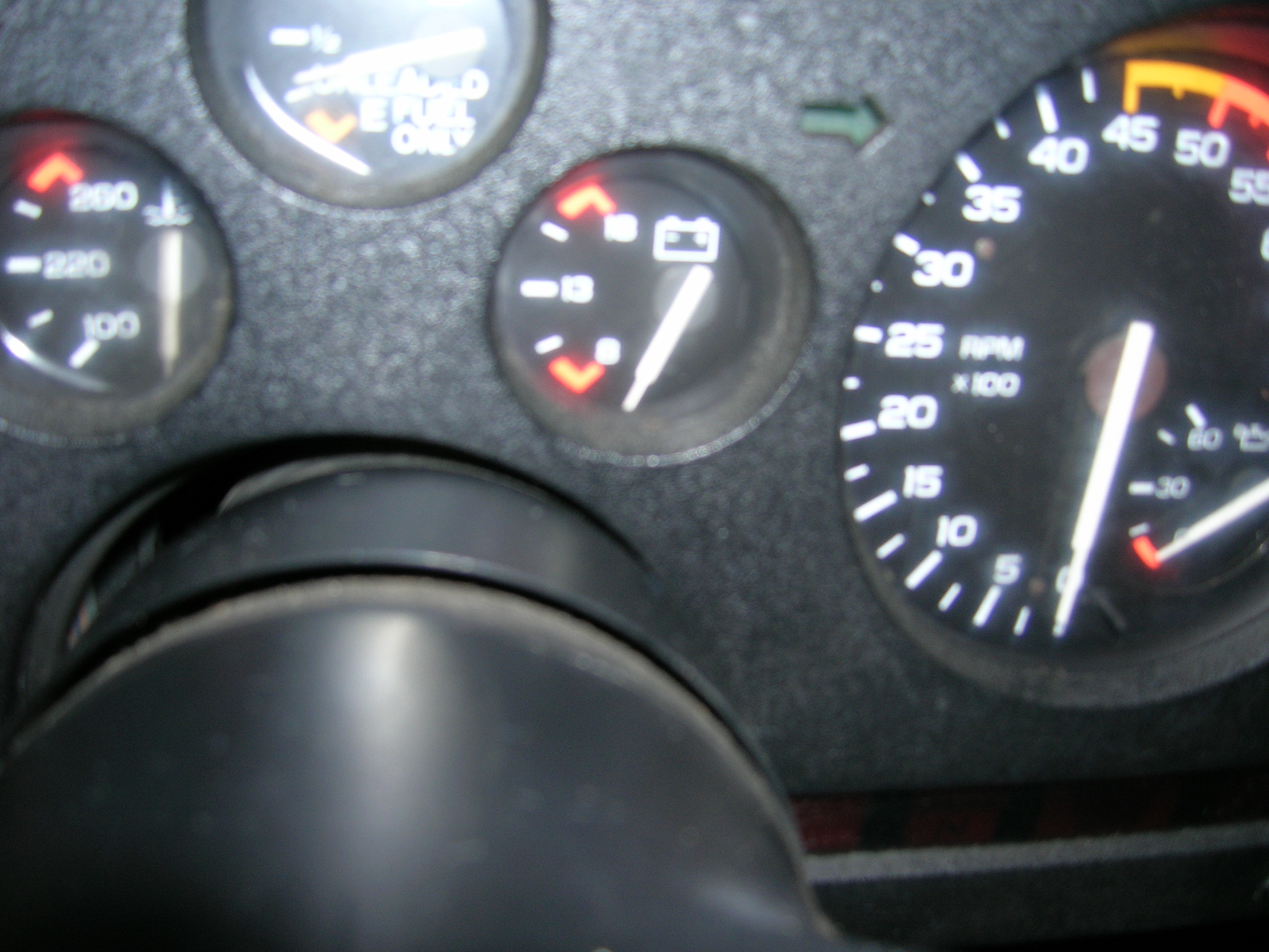

I only have the 85 mph speedo and am thinking about replacing with 145 mph . Is it difficult? any tips and or instructions or pics would be great? Is it a major project? Are each of my gauges seperate or all one unit? Here's some pics.

Its all one unit, but quite an easy project. The only small difficulty is undoing the speedo cable from the back side. Theres a tab that u push in to release it. Just a tight area if u have big hands. Going back together it just snaps in.

Each of the gauges are separate. You can remove just the speedometer and replace it alone.

The gauges are all mounted in a white plastic carrier, and will all come out of the dash together. Once that's out though, you can remove just the speedometer head and replace it alone, keeping the rest of your original gauges.

Not really. Do yourself a favor though. There are two bolts holding the steering column up. You'll want to back them out part way to lower the column so that you have a lot more room to get the I.P. out. You don't have to take them out all the way.

There are 2 10mm nuts holding the cluster in. Remove them and it will pull straight out. There are no wires or anything to disconnect.

except for the speedometer cable. I just replaced my 85 mph cluster with a 145 mph cluster in my 86 IROC due to my VSS (yellow thing on back) being bad and I've already pegged the speedometer once so I just replaced whole unit so I have more speedometer. The individual speedo is easy to replace by it self though but is held by two screws from the back of the cluster.

Yes, except for the speedometer cable. It's harder to reconnect than it is to disconnect, though.
