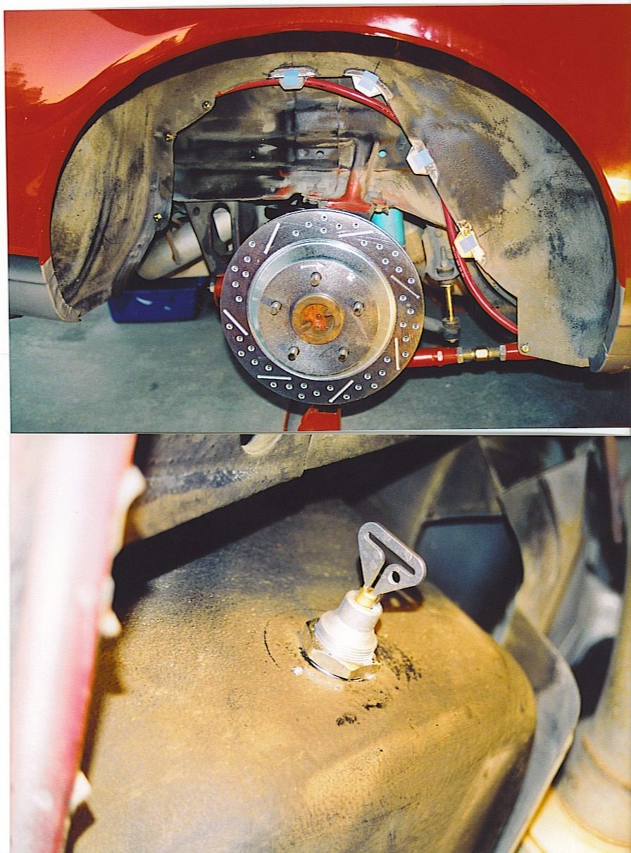

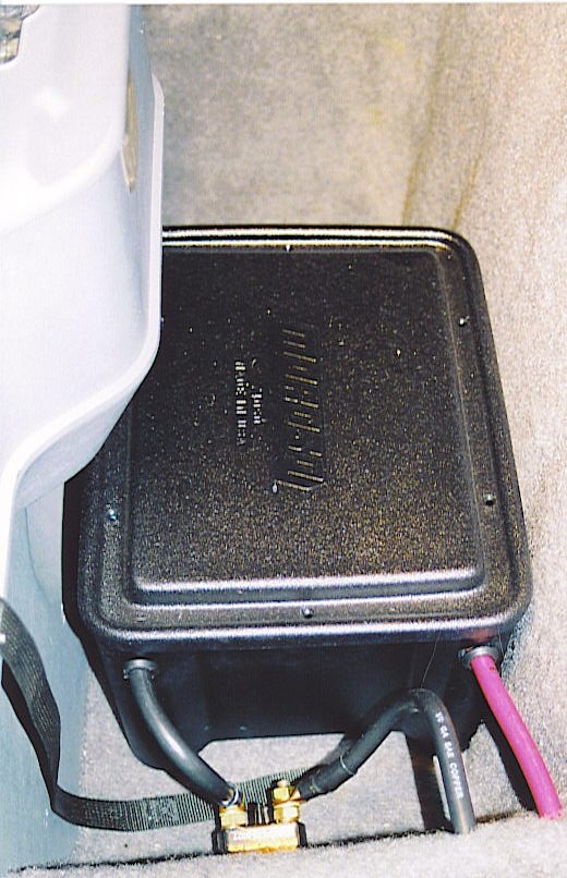

I was wondering what you guys think about my progress on my relocating my battery to my hatch. Before anyone brings it up, I know the battery cut off switch need to be on the positive wire to be NHRA legal. I don't plan on running this car at the strip, so it doesn't really matter to me. I have the Flaming River cut off switch in place to deter theft only. Also I'm not sure why, but the Moroso battery box is black, but it doesn't look that way in the picture. I made the cables myself, the positive wire runs in the channel inside the wheel well in the picture. In some places the channel isn't deep enough to place a clamp, so I'm welding tabs in place. The remainder of positive cable is attached to my Kenny Brown sub-frame connectors. I will probably place corrogated tubing over the cable to help protect it, but it will be electrically dead except when starting the car anyway, so the chances of a short are small. The other picture shows the key for the Flaming River battery cut off switch. The relocation kit I'm using is from Mad Enterprises. Anybody use it yet? Thanks in advance for opinions or comments!

Looks good man.Thinking about getting the moroso kit myself.How was the quality. Have everything you need,cable long enough?

Hmmm, I wouldn't say the kit quality was bad, but I had to make a lot of changes. First off, I didn't buy the entire kit. I got my cable and terminal ends from Wiringproducts.com. More on that in a minute. The battery box itself is pretty nice. As for the hardware...
The fasteners to hold the cover on are plastic screws. For the price ($96.88 from Summit) I would expect to get something nicer than that (maybe Dzus fasteners) because the box itself is made out of the same plastic as a milk carton and I seriously doubt it costs much to produce. The bracket that holds the battery was too small for my Optima Red Top. I gave it a little encouragement (bent the Hell out of it), but it still didn't want to fit right. It was probably about 1/8" too narrow. I ended up making my own because I didn't want to damage the battery and have it leak. The rest of the hardware was good.
If I had to do it again, I'd try Summit's battery box, P/N SUM-G1231 that goes for $68.95. It seems to be identical, except that you don't pay for the name "Moroso."
