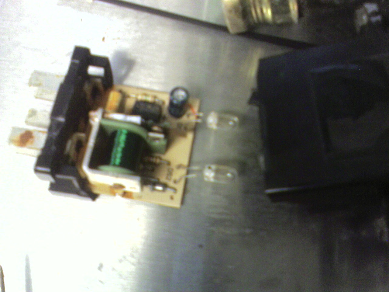

Well, the switch is.. I'd call it "somewhat" rebuildable. Seperating the housings was a challenge. I heated the seams up with a heat gun til I heard the glue popping, and to soften the plastic so it wasn't so brittle. Then I took a sharp pick and pried the housings apart. I still ended up cracking one of the corners, but some glue there and no one would know the difference lol.
Here's a pic.. of course it's a Camaro switch but I'm sure the guts are pretty similar. The two bulbs are way out in the open with lots of room, so even a soldering-gun noob with fat fingers could replace the bulbs if necessary. Finding those bulbs may be a little tough, but I'd bet any bulb with wire prongs that runs on 12v would work.

Hmm, I believe the camaro switches are a lot different than the firebird ones. On mine, the LEDs are mounted in a removable holder. Very tiny holder that uses some weird tool to turn it till it's loose, but I've just used mini screwdrivers to remove the sockets. The only challenge was removing the switch from the plug in connector. After that, the bulbs are easily removable... BUT even though our 2 switches are different, cleaning the connectors themselves is still first on my list of things to try on em! Kind of surprising the firebird ones are removable but the camaro ones are soldered on though.
Eh, not really surprising. I've always thought of the Firebirds as the slightly more luxurious car on the F-Body platform. I don't know if you can tell in that crappy pic or not, but the backside of the coil is completely corroded. I guess the amount of juice flowing through this thing is pretty condusive to corrosion. The spade that the current leaves through also has some nice cancer on it.

I see a lot of corrosion or rust where you're pointing it out. I don't remember mine or the junkers I took having similar corrosion though. I wonder if it has to do with materials used, placement of the switch or even what area of teh country it comes from. I also have a switch similar to yours there and I notice after playing with both that the camaro switch has, what seems to me, an OVERLY firm click into position when you turn it on whereas the firebird has a much softer click. The camaro one also feels a bit on the, i dunno, rougher? side. Kind of reminds me of those toggle switches you can get at radio shack. They're generally clunky feeling when you press them where my firebird one is a lot smoother.
You'd think they wouldn't have gone so radically different on the same exact switches. They didnt have to place em in the same spots, but they sure could have used the same guts under the button itself. Car will be home soon so I can check out the connectors then.

I actually did rebuild one of those in my camaro. If replacing one of the bulbs qualifies as rebuilding. I replaced the indicator (lights with dash lights) with an LED and a 100K 1/4 watt resistor in line. It now lights the symbol green instead of yellow.
