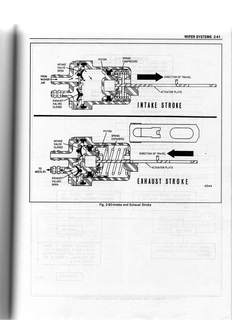

Badman
When you installed the brand new pump, did the pump assembly include the valve assembly that is attached with four screws to the pump piston chamber? I have no idea what you get when you buy a new pump.
I don't think the circuit board is your porblem. It is used to generate the time delay when the wipers are turned on in pulse or delay mode. If the wipers are operating in pluse mode and you operate the wash switch, the timer circuit is bypassed by a mechanically dirven electrical contact, so the wipers will operate to WASH the windshield.
If you did not replace the valve assembly, then it is possible the intake valve is damaged, borken, etc. If if does not close completely on the exhaust stroke, it will drive fluid and/or air back into the reservior causing the air bubbles you are seeing. I am also wondering if the gasket between the valve assembly and the pump has a small crack in in allowing air into the pump chamber on the intake stroke. Correct operation of the pump is exhaust stroke, intake stroke, exhaust stroke, intake stroke, stop, until wash switch is closed again.

I don't think our pumps work like that. I have taken one apart and it is just a rubber "waterwheel" that spins in a houseing.

The replacement pump comes complete with hose fittings. Simply unclip and pull out old one, push new one in housing and reinstall holding clip. Then reinstall housing. As for all the various wiper speeds, delay, and operation of the washer pump, all is working as it is suppose to, with the exception of the pump running backwards. So today I am going to make 2 jumper wires with connectors,install in housing,then connect to pump motor, and see which one is getting power when I hit the switch. If it powers from the "wrong" terminal, then it is getting crossed somewhere, probaly the wiper cover circut board. After that, I have no idea what else it could be. When I complete this test, I will post results. Badman
