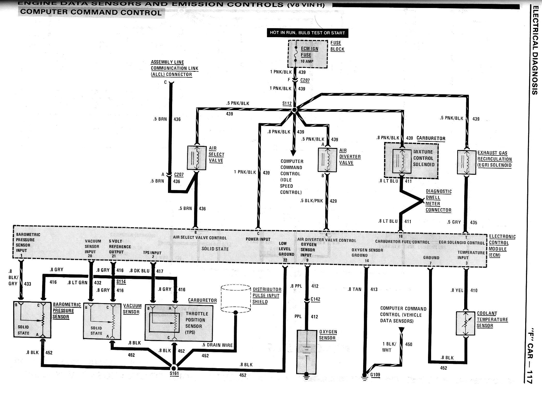

Great, just great. I plugged in the new ECM and as soon as I turned on the ingintion, I was greeted by the "Check Engine" light. Error code 32 (Barometric Pressure Sensor voltage too low).
I take a look under the hood and I cant seem to find the darn baro pressure sensor anywhere. I finally find a green 3-pin connector cable-tied to the wire harness behind the engine. I look at the wire and it is gray with a red stripe, the same as the cable going to the ECM terminal 1.
WTF!?!? Did someone yank out the baro sensor at some point or did some cars come from the factory without one? My previous ECM did not give me the error code 32 so I never knew until now.
Can someone provide me with a closeup picture of how the Barometric pressure sensor is mounted on the car? Thanks.

Re: Will I have any problems with this ECM?
It depends on the engine type, which sensor setup was used.
I found an AHWJ chip in a '88 Caprice Classic Brougham LS (B-carline) with an LG4 (H-engine).
Take a look at this thread and see if there's anything you can use.:
https://www.thirdgen.org/forums/diy-...-diagrams.html
Here's also a sensor wiring diagram for an '84 T/A.
Attached Thumbnails Will I have any problems with this ECM?-engine-data-sensors-emission
