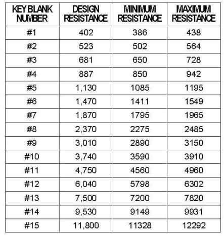

Now that you know how to fix it, you could get 1 resistor (910 ohm) instead of putting 9 resistors in series. Any resistor between 850 and 942 ohm should work acording to this chart I got from another thread.
