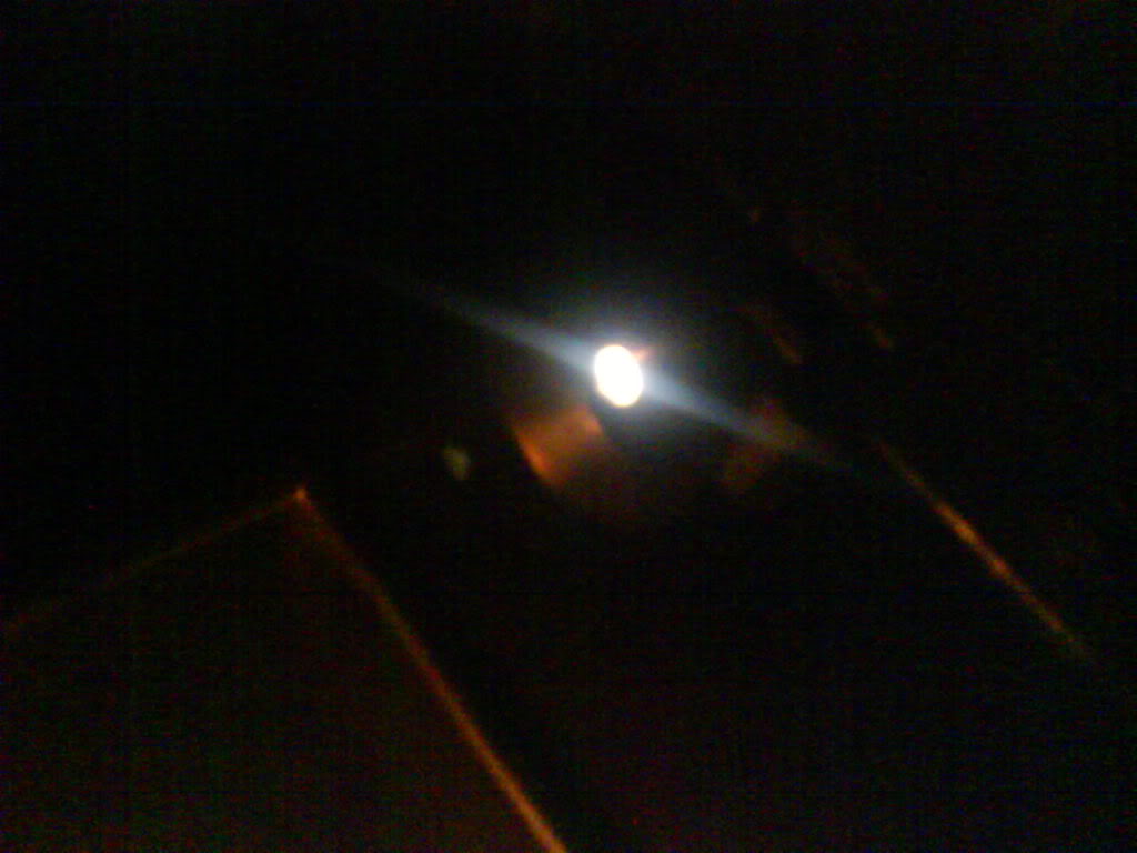

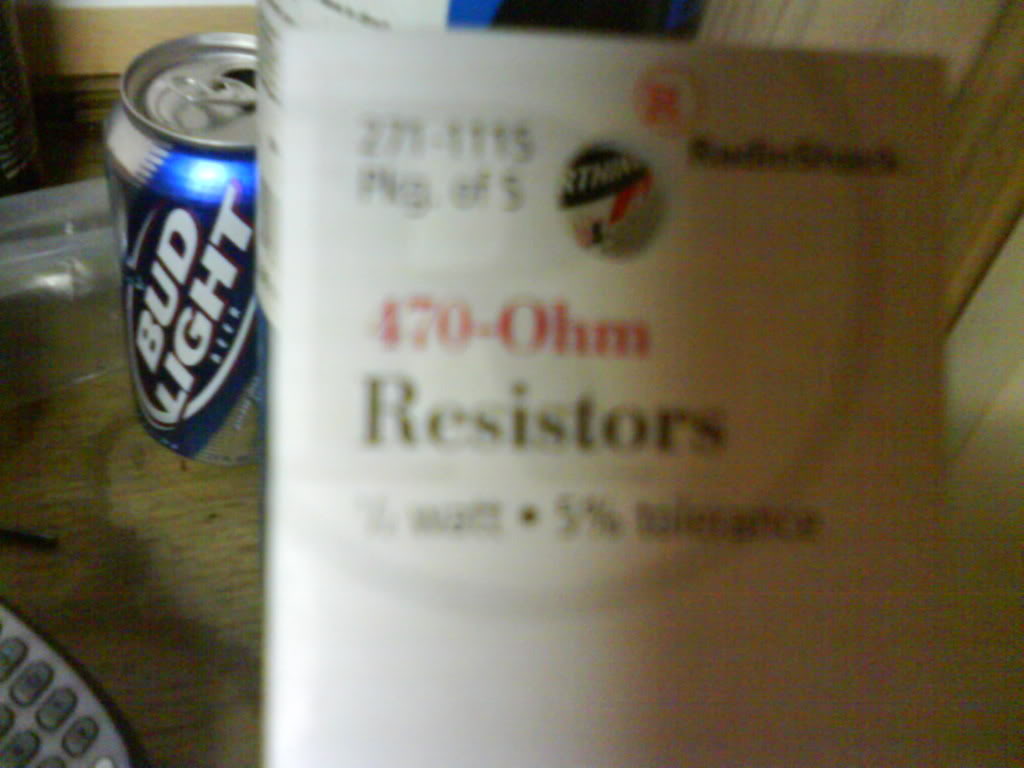

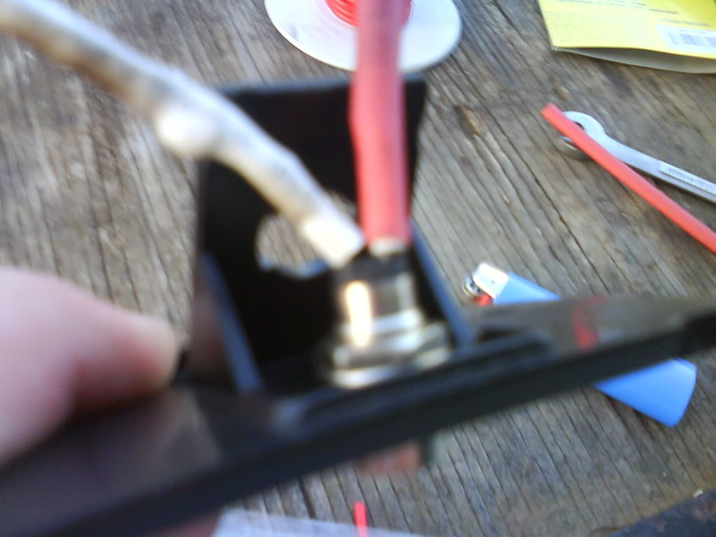

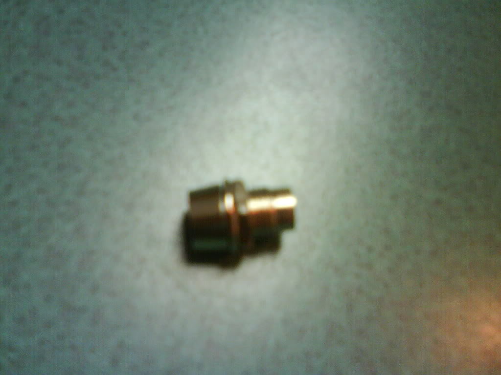

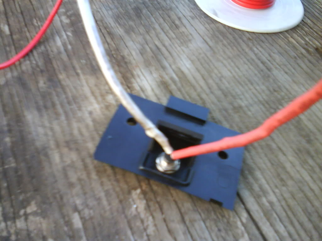

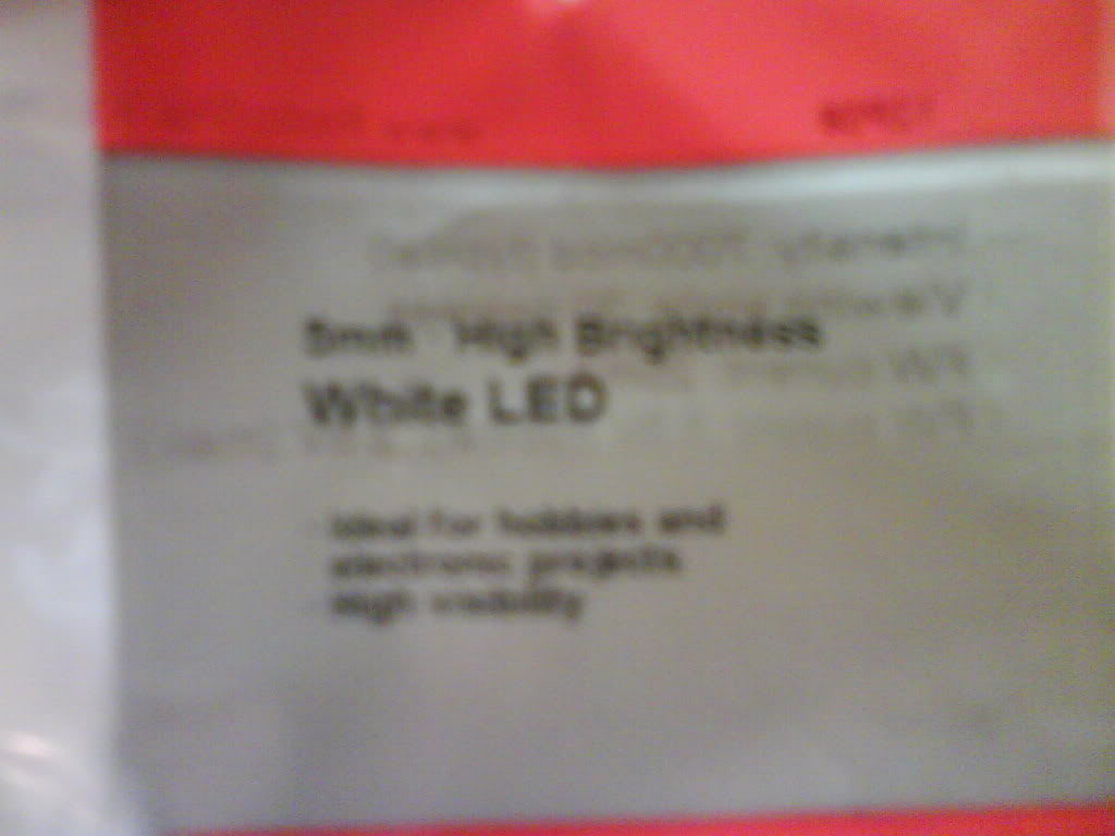

umm yea scratch that last message LOL, i just went to replace the bulb in mine and take a pic, and realized i have no bulbs in its size, but i will leave you with this, its a LED light i put in my center console, its wired to the dash lights, it really helps to find stuff at night, all it is, is a white led from rat shack, got a resistor and a led holder for it, looks good, works and its bright, pics you really cant tell....i used the hole thats inthe console from the factory, i think its the hole that the adjuster for the center console clock went, so if you got the center console tic toc than you need to drill another
hole

Wow that's a good looking LED man. Very clean. I should do something like that in my T/A.... except orangish/red. Man I still can;t believe how amazing these cars are. I've had mine since July and i am still in awe of it. Sometimes I just stare it pictures and go wow.... gorgeous. It's in winter storage now but it'll be amazing in the summer

Here is the start
7000MCD LED, p/n 276-0017
Resistors 470 OHM
LED Holder (sorry no p/n had a few in the shop)

ok here is the rest of the story
soddered up the wires put the resistor on the positlve side (its the slightly longer lead on the LED) and heat shrunk them
ran a piece of heat shrink over both wires and the base of the light

here it is on, sorry my cell dont pic up low light well, but i will say it lights up the ashtray and shifter good

Man that looks pretty good. Any chances of getting a better quality pic?
