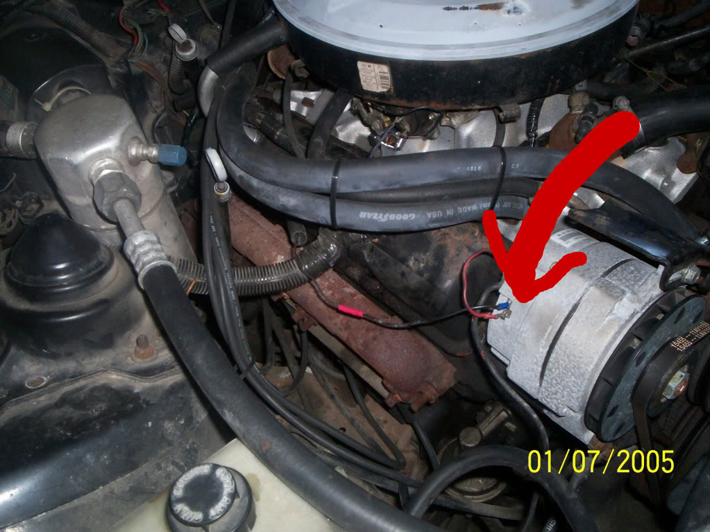

Check your timing. Mine didn't want to start, either, until the timing was reset, THEN I figured out that the yutz who had it before me had reversed the alternator wires, so it was drawing instead of charging! Now that it's fixed it's better...but you're right. These cars do NOT like to sit around. The more I drive it, the better it is...now if only I can keep from losing the battery altogether...

Ummm....well, I *think* it's the alternator... Under the hood is where I'm NOT so good. Maybe I can take a pic tomorrow or something. There were two wires under my hood that were reversed. When we switched them, the alternator started charging. POOF!

Okay...THESE are the wires I'm talking about. They were reversed so the battery wasn't being charged.

to blg0720 I still have the original clip there so that is not a problem thanks for the picture though.
