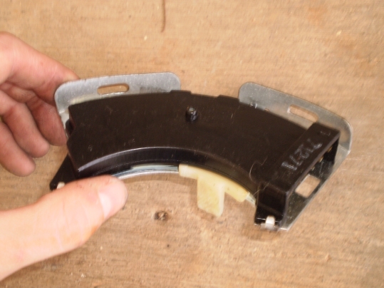

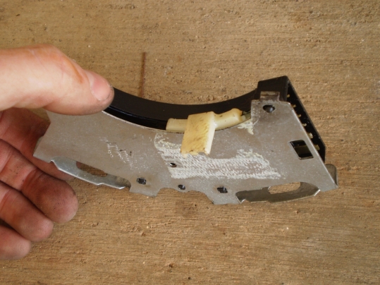

I think I found the part is it this semi circlular piece?

that is it, but i cant remember what wires are for the r- lights

Do they sell this piece anywhere? Like at checkers? Or special order threw GM? Or another site or something?

Also, I noticed, the 2 bolts that are supossed to hold that part in, were not there at all. It kind of just sat in there. Is the piece I have in the picture supossed to go under the tabs or over when you bolt it back in?

Hope this thread helps someone else out sometime. That part in the pics worked. The reverse lights work again, and in addition to that, the car will no longer start up in any gear it wants, has to be in Park, or maybe neutral too.

Great job, glad you figured it out!
For anybody: AutoZone for exapmle sells a replacement switch for $17. Duralast part # DR414. You just gotta ask an employee who can read, type and think.
