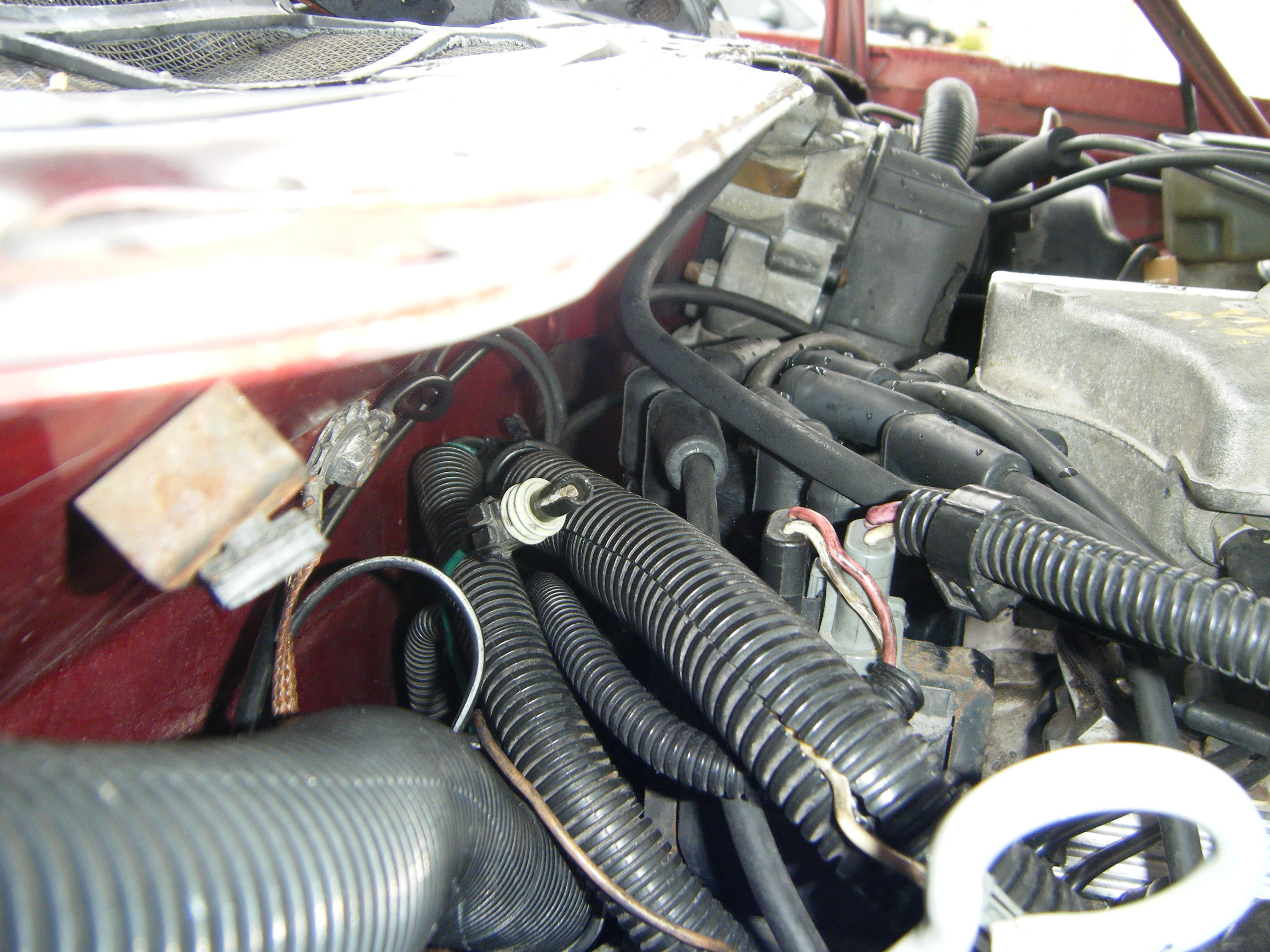

This is a photo of the MAT sensor and the wire attached to it that is not plugged into anything

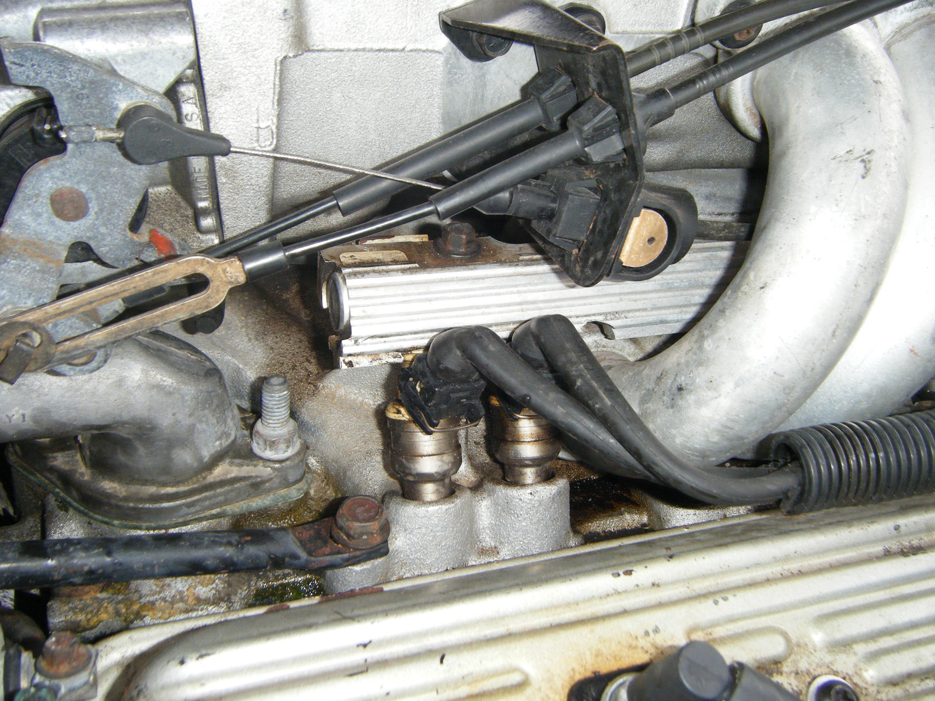

I also have another plug that I have no idea where its from and where its to plug into any advice would be greatly appreciated.

The wire from the MAT sensor (also called IAT sensor, but it's neither, it read the temperature of the METAL INTAKE
- good ol' Cheby) should plug into the harness behind the driver side valve cover. Look for a the other end of the plug you found.
It is also possible that the new harness didn't come with this plug so the shop simply left it unplugged (yeah, they often do crap like that).
I can't identify the second plug, that's a dark green wire, right? Hopefully somebody will chime in shortly.
