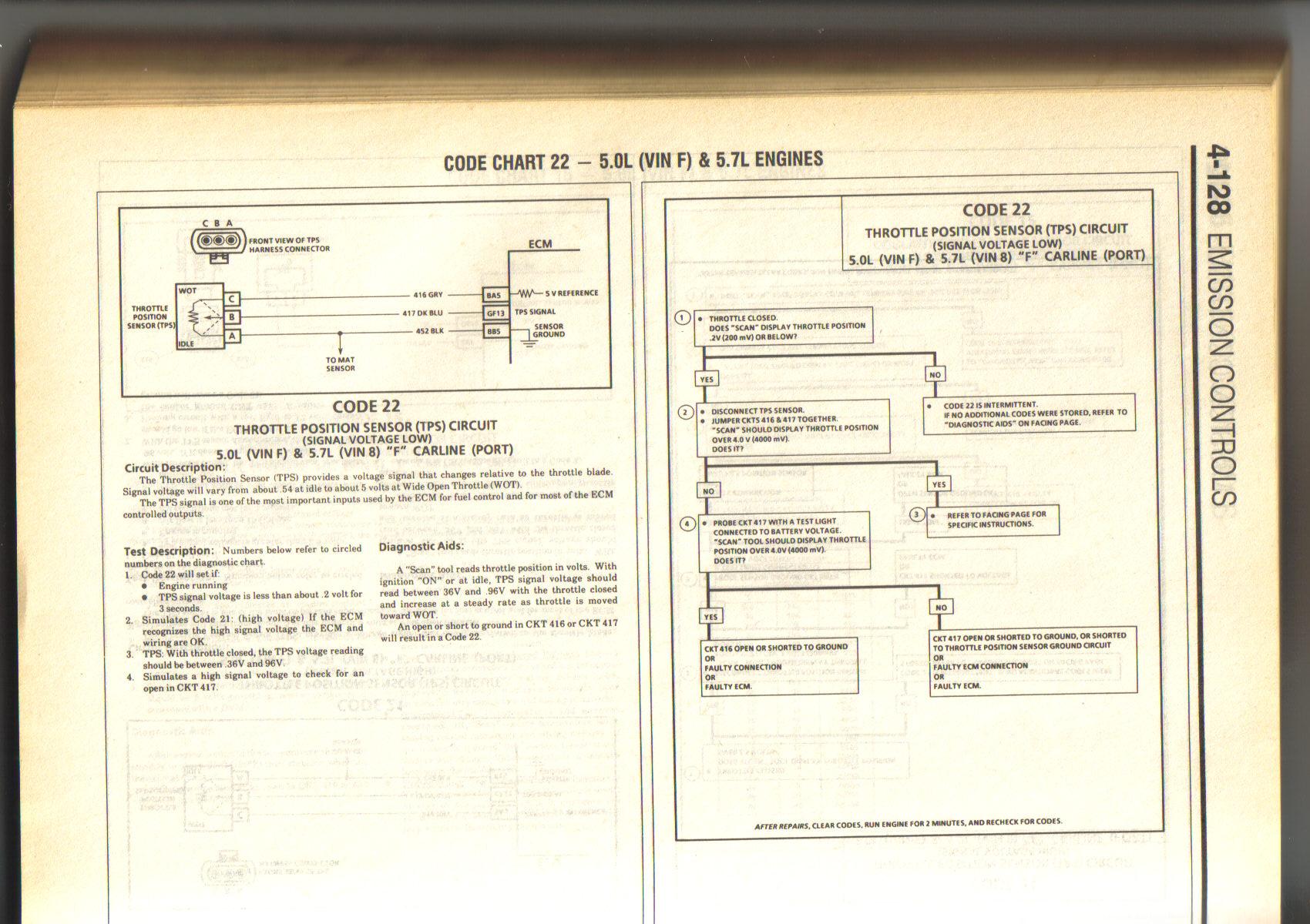

I dont think that it would be a sign of a bad fuel pump. I would be most likely a bad or misadjusted sensor or wiring problem. Worst case would be a bad ecm. Here is a chart to help you diagnose the problem.
Attached Thumbnails Can a code 22 be a sign of a bad fuel pump?-code-22-2.jpg

is it for the TPS?
i got that code but i forget what it said it was for on all data. ether oxygen sensor, egr or something else.
