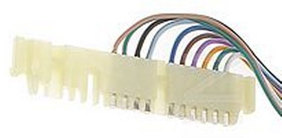

You can take a test light or voltmeter and probe the light blue and dark blue wires on the front park lamp sockets (easily accessible from underneath) to check for voltage.
You can also drop the driver side knee panel and probe the flat connector on the bottom of the steering column (once you drop the knee panel, the connector is right there, in plain sight). Again, the light blue and dark blue wires, those are for the front signals. (picture of connector here)
If the front signals flash with hazards, I'd suspect the turn signal switch in the steering column. If they don't flash, I'd suspect the wiring or sockets.
