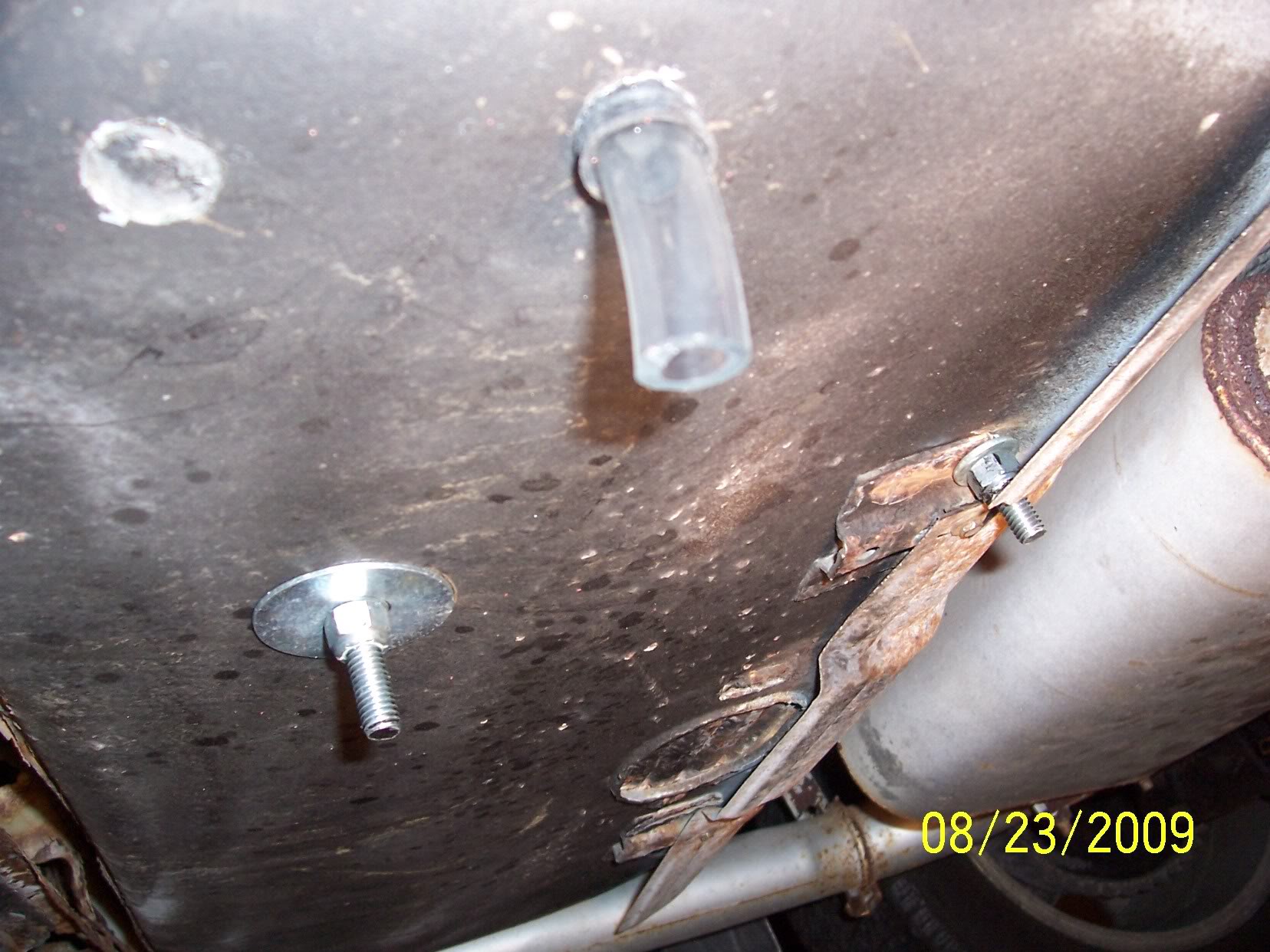

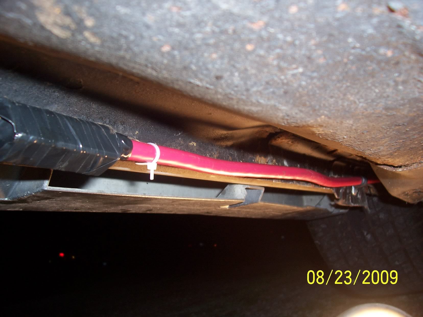

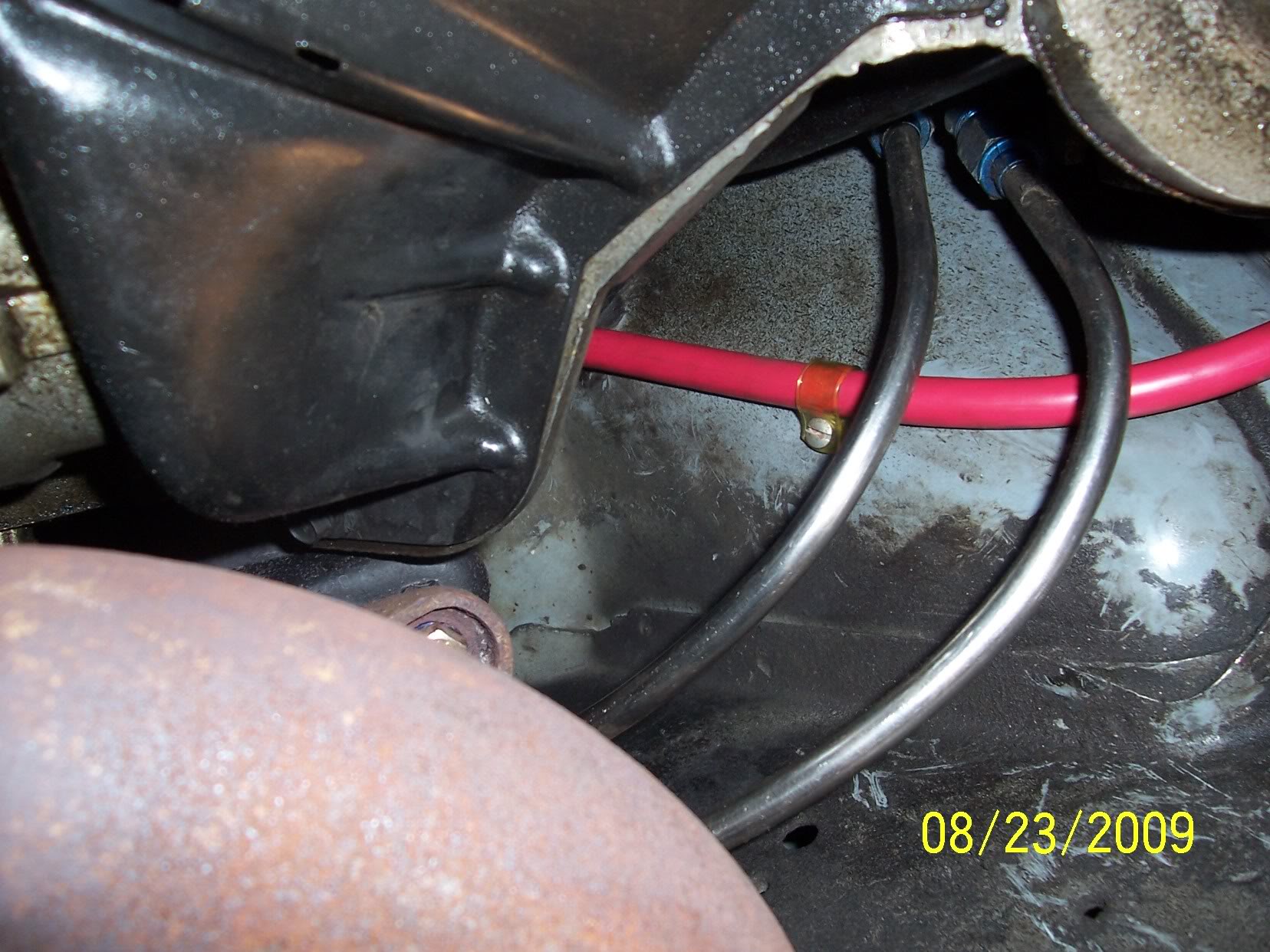

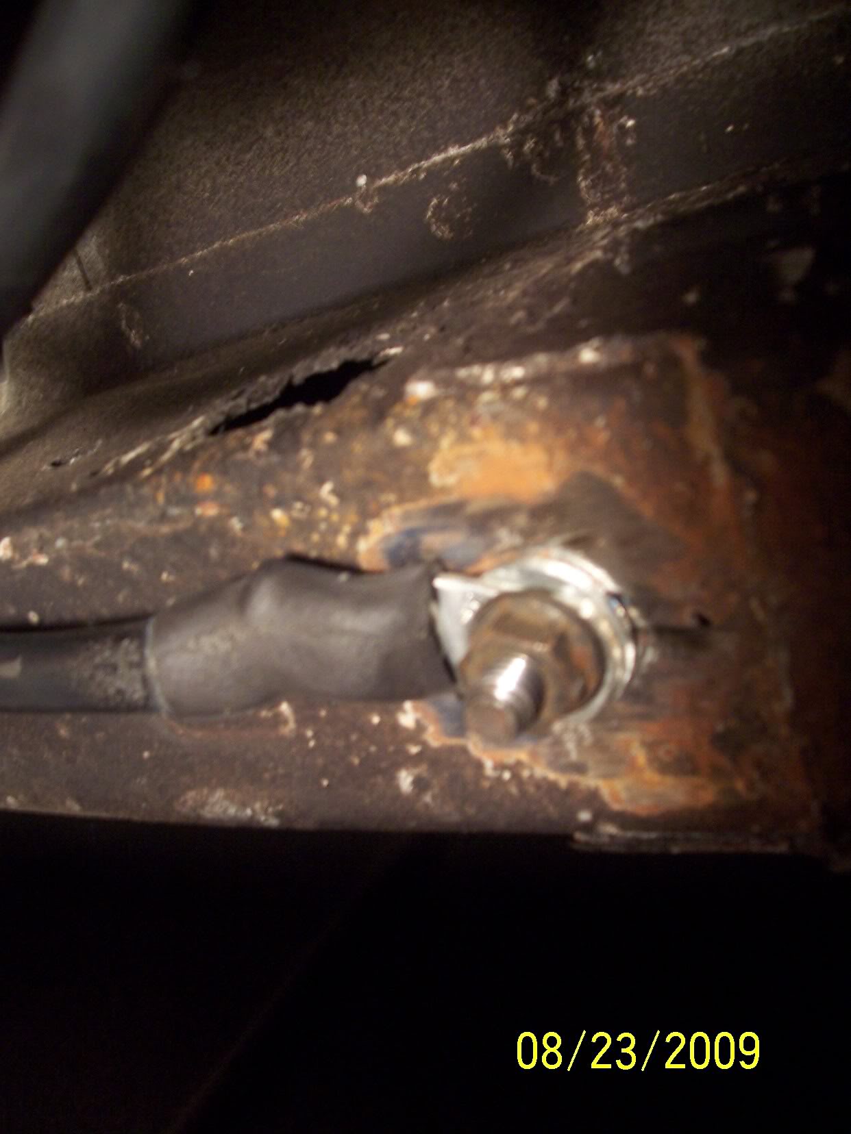

Only took an entire day, but things went fairly smooth. Working alone without tunes does suck though. No real complaints with the kit either. Super score too, $70 on craigslist!:
http://www.summitracing.com/parts/SUM-G1231-K/
Summit SUM-G1231-K
Tucked the cable up under the wheel well, and kept it away from heat of course. Grounded to the chassis, then primered. With some patience and a great gf holding the light. things worked the very first time. (which is a miracle) Minimum sparkage too!
Enjoy:

what gauge wire is the positive?

Why not put it in the spare tire well?

Too big. No way it'd fit in the tire well. positive wire is 1 gauge.

Ehhhhh it should. I know mine isnt in a NHRA box or anything like that but i have a power cell(deep cycle battery) which runs my system that fit perfectly in the lockbox.
Either way it should help with launches! Good work.
