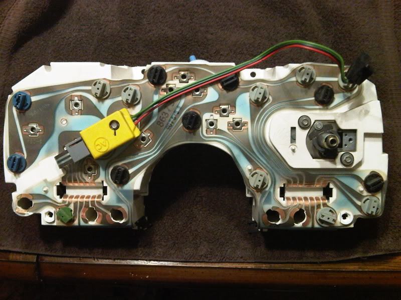

HOOYA -
I just took some pictures of an instrument panel I removed from a 1989.
You'll have a spring clip you have to press in towards the panel while you pull the cable out. The cable is not threaded - it's just locked into place by this spring clip. After you do that you'll have to disconnect the tach connection.
I hope this helps you out a little - I'm on the West Coast and I have to hit the sack now - I work graveyard shift. I'll post the pics tommorow before 12:00 noon West Coast time.

I know the speedo has a cable & its held on by the clip mentioned.You have to pull the cluster far enough away from the dash.Then reach behind the cluster & push that clip.The cable housing will then release.There are no other devices holding the cluster on.Other than the two bottom 10mm nuts.

...sorry I took so long posting these pics, I got a little ties up with one of my projects. I hope these will help you.
Jimmy D.

Thank you so much for the pictures, it will make this much easier knowing how it all is supposed to look like. thanks again bro.
