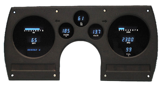

90-92 is different form 82-89. Dakota Digital will have you send in a ready to install panel that they will retrofit their stuff into. Takes about 90 days turnaround time and cost about $1100.
This is the one I had done by Dakota Digital for my 92 RS about 5 years ago, it was about $900 then.
Nordskog makes one also for the 90-92 Camaro for $500, they have it labeled 91-92 though.
http://www.nordskogperformance.net/p...&cat=10&page=2
BTW, none of these are plug and play, there is alot of cut and splice to do to your harness so you can run signal wires to the panel's CPU. I spliced mine so that I could put a stock piece back in just by removing the taps from the wires.

Here's my Blue Nordskog's...
Heavy wiring is involved, but you do retain your stock pins in the back. You need them so the circuit board on the back of the cluster can actuate your turn signals and warning lights.
